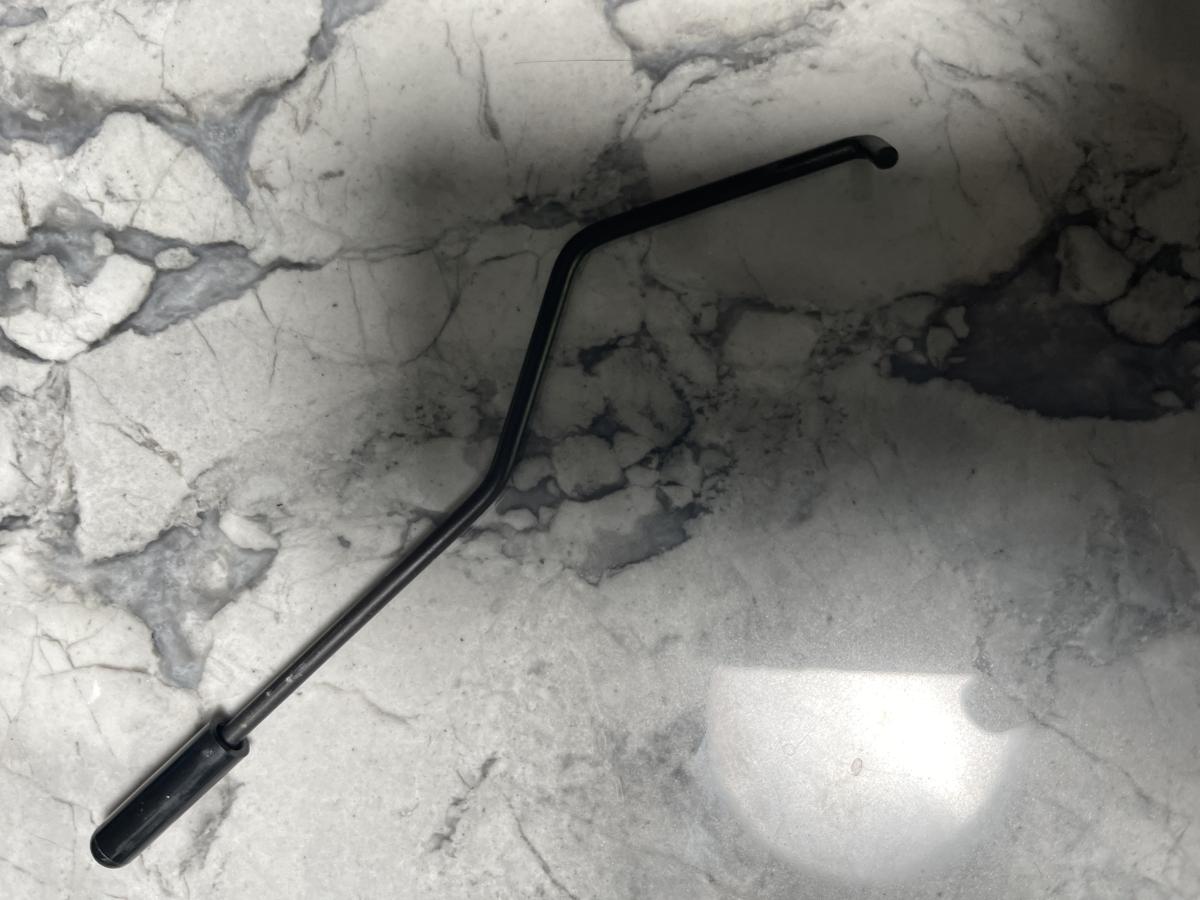

    So, was removing the passenger door card for the '02 M3 today and the manual actuator for the door lock fell into the bottom of the door. Anyone have suggestions on how to reinstall this. I can't see in there and not sure what it hooks to or how to put it back. Any help appreciated.

    There is a clip the end of the rod slots into. See first pic in this thread
    My first DIY how-to, so hopefully it makes sense to everyone. To start off, this write up is assuming you have the assembly removed from the door already. There are several how-to's on that so take your pic. The first section is devoted to rebuilding the locking mechanism. If you are having...
      Thanks for the info, I appreciate it. After reviewing the pic you sent, (thanks much for that btw) I still could not see in there but was able to snap it back in place last night, Super happy it did not fall out after the door panel was put back on.
