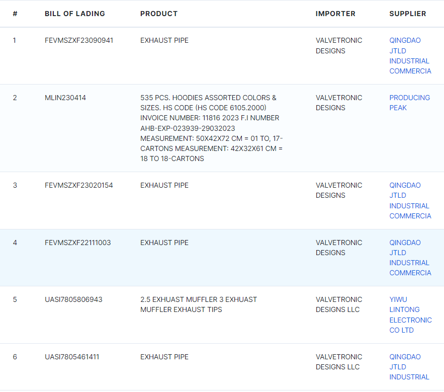

    Never even heard of these guys so I'm guessing it's made in chinastan due to that and qc issues.
      You'd guess correct:
