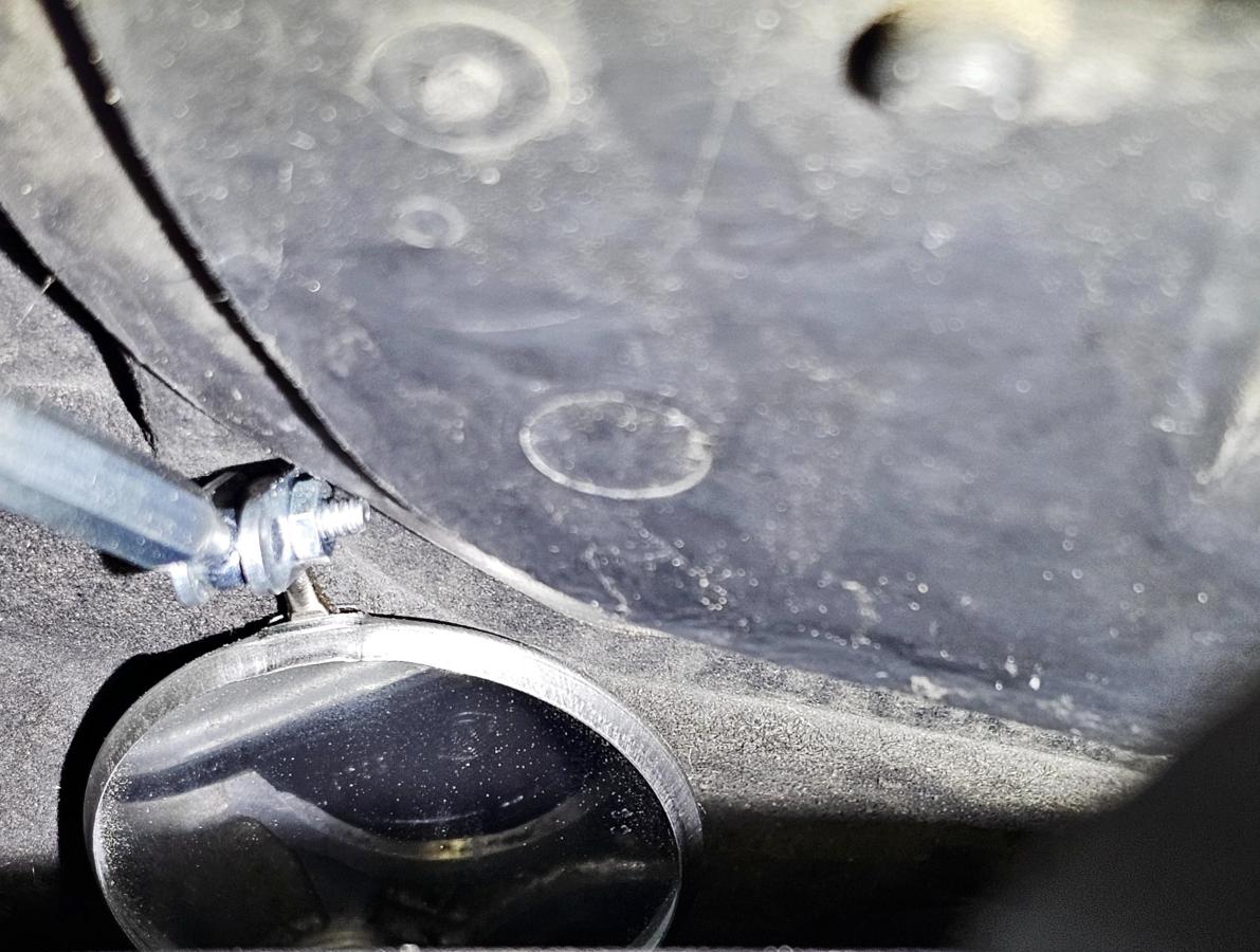

    5. I did try to get an inspection mirror behind the engine and THINK I may have seen some oil weeping out what I assume is the valve cover gasket (see image)

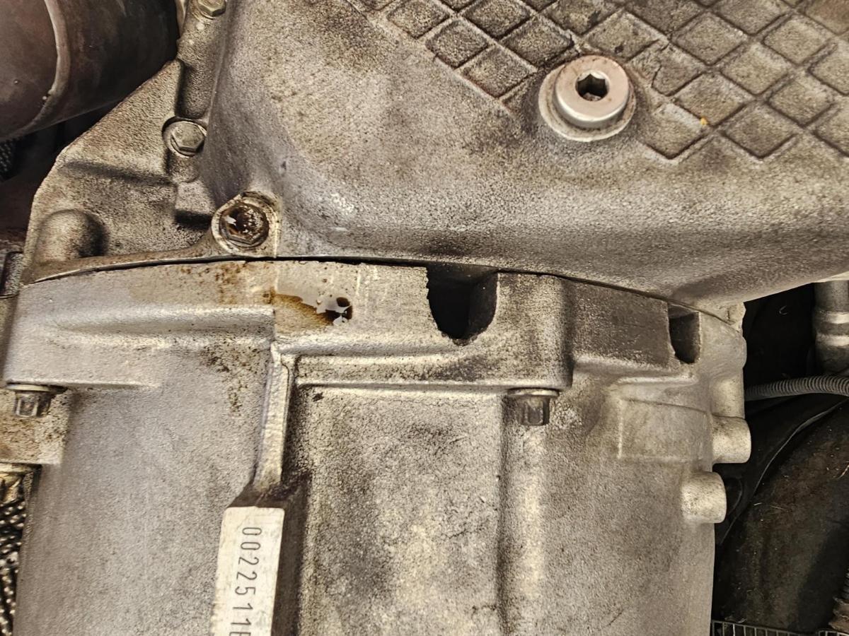

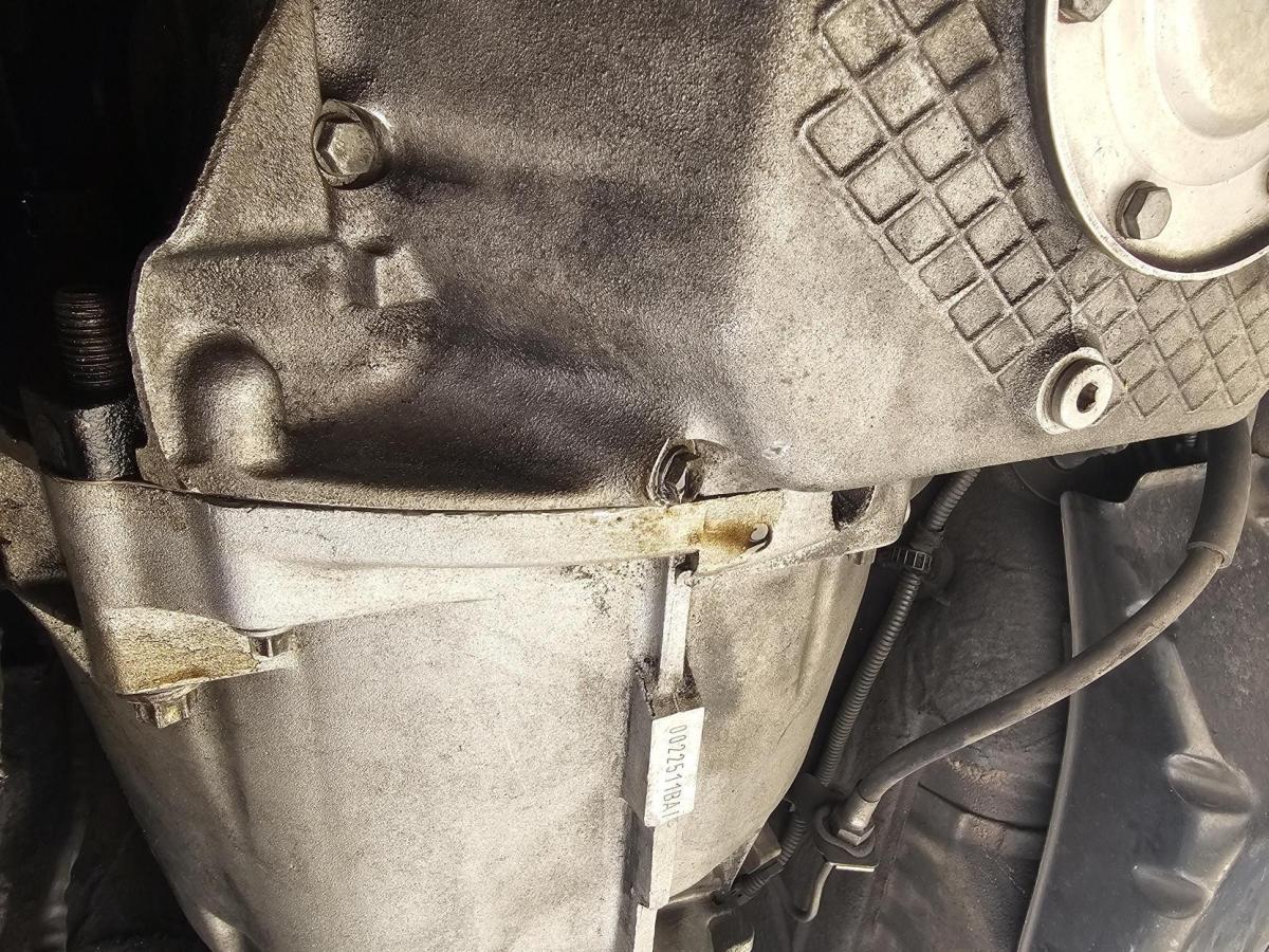

    6. I do see oil coming out of what looks like the junction between the motor and the transmission (see image)
    Click image for larger version  Name:	Media (1).jpg Views:	216 Size:	263.0 KB ID:	266192 Click image for larger version  Name:	Media (2).jpg Views:	216 Size:	223.4 KB ID:	266193​
    Part of me is wondering if the boost is causing the crank case to pressurize and forcing oil out the seals, but if that was the case, I do not understand how I am also burning oil as I would image the blow-by causing the crankcase to pressurize wouldn't allow oil in the cylinders.
    So at this point, I am thinking valve cover gasket (based on first
    pic above) or something between the tranny and engine.....what am I missing? what else can I do to help isolate either my oil burning or my oil leaking issue? 10W-60 is expensive!​

                    That droplet forming on the bell housing is exactly what I found when my CPV was leaking. So, check that and the VCG, cam pos sensors, oil level sensor. But yes you might be burning it internally as well.
