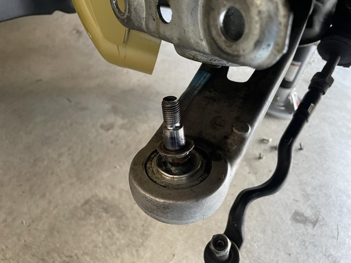

    While removing the front knuckles to refurb them I damaged the boot on the passenger side, I was very reluctant to spend 300 on a control arm just for a stupid rubber boot. So I came up with the idea of sourcing just the ball joint, which is available for non M control arms from Lemforder to harvest the boot.
    bloddy hell, those rings are a PITA to remove, but is doable after watching some YT videos on how to remove these boots on some Japanese models.
    the image below shows the naked ball joint.
    I will post photos of the boot and clips that hold them in place.

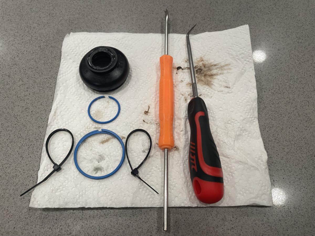

          Received the donor ball joint and removed the boot.

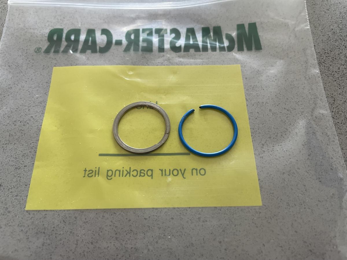

          The blue rings are the originals. the larger ring is called a retainer ring, and is like the ring of a key chain, the smaller ring is more of a snap ring that is pretty tough. I used a shallow pick to just get it behind the ring and pry it out carefully. I chose not to install this smaller ring as I am sure I would end up punching a hole on the new boot trying to install that thing on. instead I got another retainer ring from McMaster, it is basically identical to the larger one but smaller, and lucky me McMaster happened to have one of identical diameter.
          Click image for larger version  Name:	IMG_0805.jpg Views:	0 Size:	100.4 KB ID:	271556
          You can see below the retainers. And the tools I used. The zip ties are to pull the ring apart to wind it on and not damage the boot. When I receive the small ring tomorrow from McMaster will share the photo
          I trailed installing the torn boot onto the new ball joint to learn the process. The ring retainer that looks like a key chain ring is easy to install, just wind/unwind it around with the help of pick. You can also fish in a zip tie to spread the ring apart and start unwinding out.

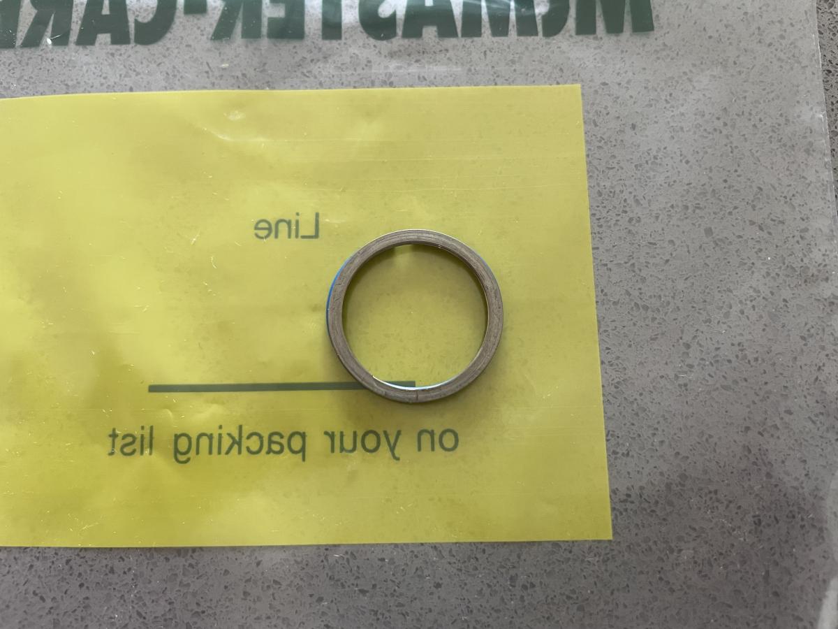

              The ring came in. Exactly the same size but much easier to install.

                does the blue ring always has the gap or this was created when you tried to spread it out during removal? when installed I would expect the gap is minimal otherwise this can lead to water got in. (Same for the brake caliper dust boot ring which is not a complete circle allowing water to get in at the ring gap, but I always added some grease inside the boot to seal off this area.)
                I like the key ring style ring better as it creates a complete uniform 360 deg pressure for a good seal.

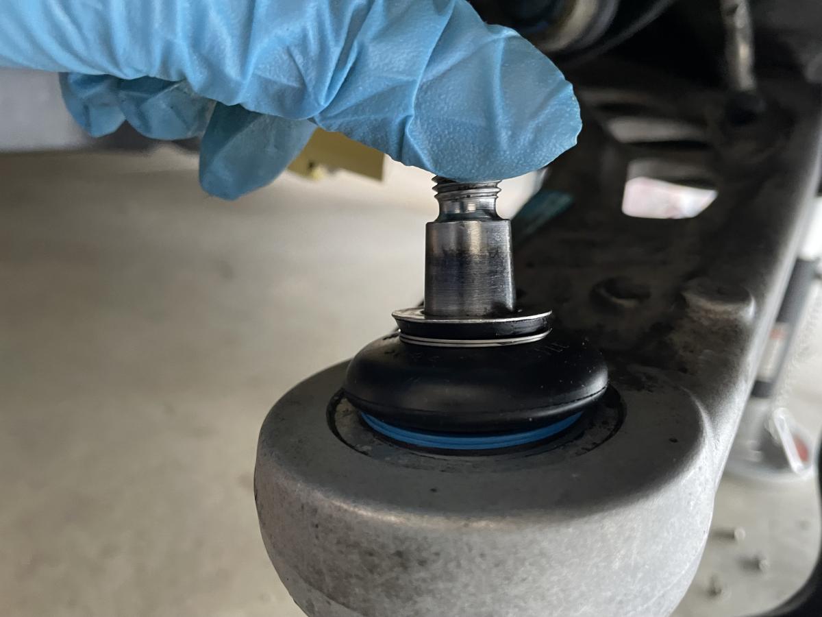

                    Job done!!!
                    Click image for larger version  Name:	IMG_0810.jpg Views:	0 Size:	80.2 KB ID:	271931
                    to answer the questions above… when installed the blue ring does not have gap (before removing), i actually think I bent it a bit during the removal process. The same happened to the original ring which was yellow. That was one of the reasons I replaced it. You have to spread it open some!

                    ones installed both rings were perfectly circular
