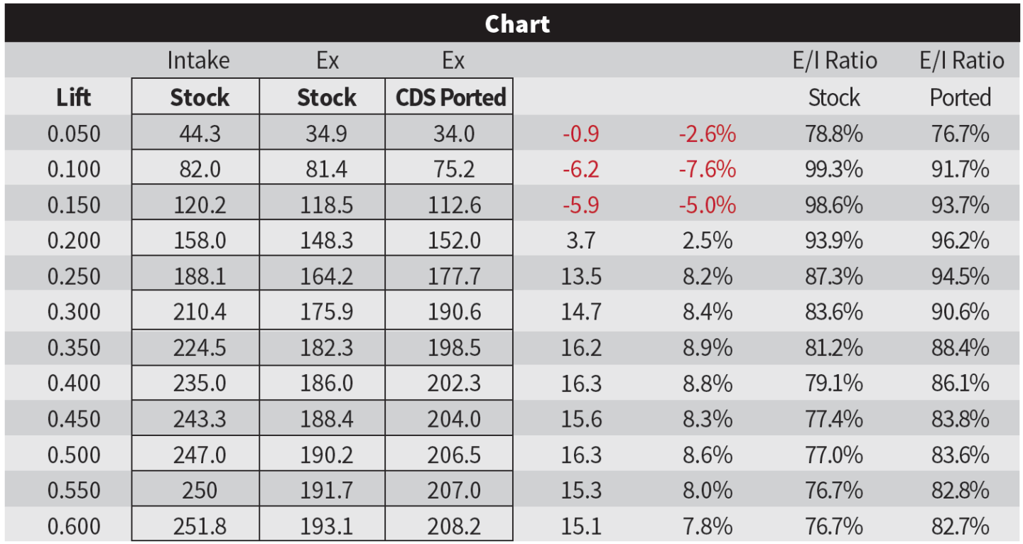

        I've found flow chart of stock intake vs stock exhaust vs ported exhaustClick image for larger version

          there is no question there are gains to be had, but that’s not the “issue”. It’s about what the engine actually needs to make more power and more flowbench cfm on the exhaust port is not high on the list
