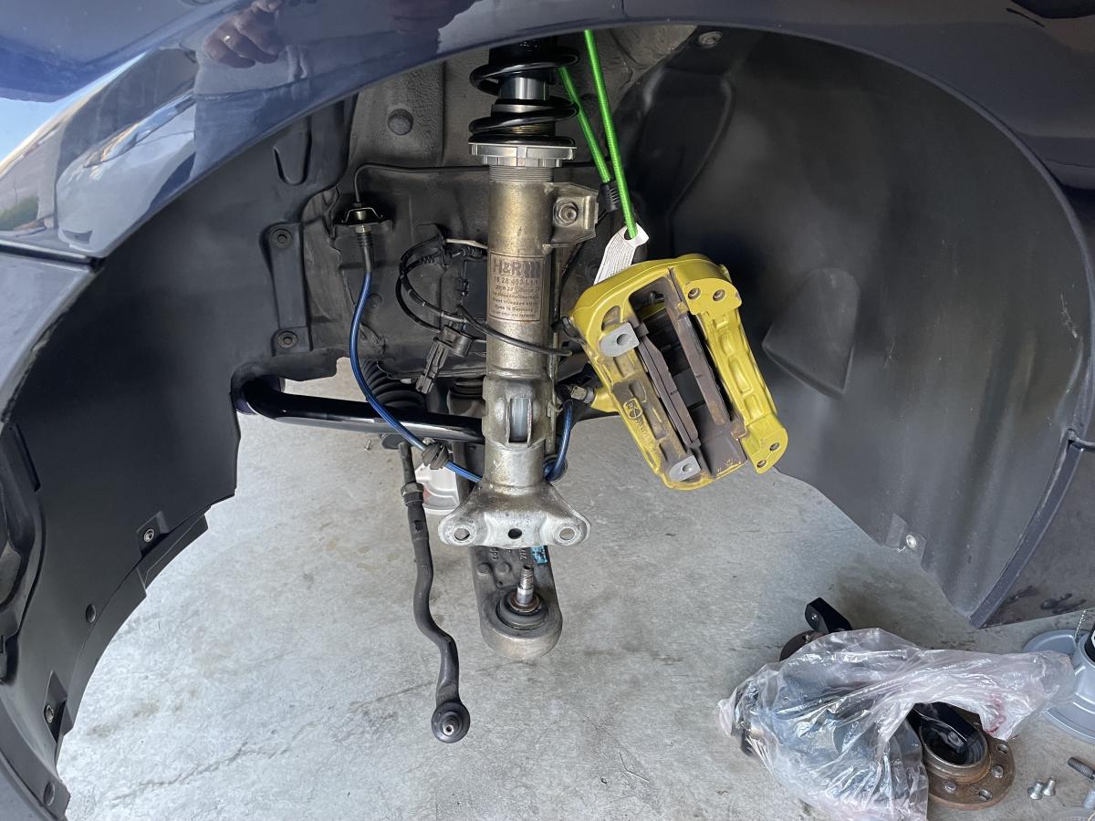

                      I have H&R coils but dit not like their stiffness, I went Swift since it has pretty much any rate you want. I went with 225 front, 600 rear. But my plan is to lower the rear to 500. For rears I chose TCK.
