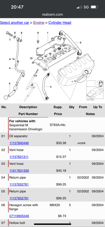

    What does it look like? There are two: the larger one that goes to the idle control valve which you have to squeeze to remove and the smaller one that goes to the oil pan and has 4 prongs that secure it to the airbox.

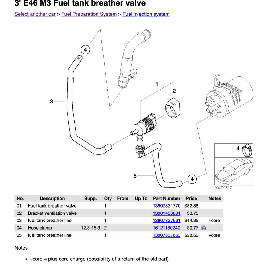

      I think it's #3 in the diagram but not certain. There's a nipple on the under side of the box in the center that a hose goes over and a sliding clip to lock it on. My clip won't lock on any more so I'm trying to replace that hose because I keep getting EVAP codes.
        Number 5 below

          Sent you a message last night from my phone, following up here with more info and photos.
          There are two connections on the underside of the intake.
          Click image for larger version  Name:	e46-m3-throttle-body-icv-2.jpg Views:	0 Size:	145.0 KB ID:	272790
          The one closer to the front of the car 13417837597 (LINK HERE) (REAL OEM LINK)
          Click image for larger version  Name:	e46-m3-throttle-body-icv-15.jpg Views:	0 Size:	348.8 KB ID:	272789
          The one closer to the rear of the car 11617831930 (LINK HERE) (REAL OEM LINK)
          Click image for larger version  Name:	e46-m3-throttle-body-icv-28.jpg Views:	0 Size:	192.8 KB ID:	272788
