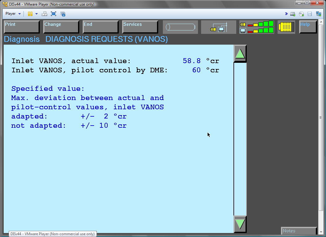

                              So running active test on vanos inlet Vanos is stuck at 60° and inlet Vanos pilot control by DME is stuck at 51.20 and not changing with rpms or speed. Adaptation is .50. Exhaust side is 0° at idle and DME pilot is 0° as well. Exhaust Vanos changes with throttle and speed.
                              so is there an issue with the inlet Vanos or is it supposed to stay at 60° most of the time. Just weird that DME pilot control is lower than actual value.

                                Let's just be crystal clear on nomenclature here: rather than the actual VANOS TEST function in DIS which tests response time and estimates leaking etc while at idle, you're referring to just monitoring the VANOS Actual vs VANOS Pilot DME values right? The numbers you're discussing are something that I've consistently seen on my car, and I've always wondered about. At idle I'm usually seeing "Inlet VANOS, Pilot Control by DME" (which is what the engine is commanding) at 51.20 whereas actual is sitting at about 60. Adaptation 0.90, so the adaptation itself is totally within spec but the pilot-actual value is not.
                                I've posted about this a few times on the old forums and nobody seemed to think it meant anything bad because the actual "VANOS Test" passes. HOWEVER: if you look at these values in DIS, it tells you right there on the page that if the VANOS has been adapted then the maximum allowable range between the pilot and actual value should only be +/- 2!! Whereas if adaptations have *not* been performed yet, then +/- 10 is allowable. See this photo:
                                Click image for larger version  Name:	proxy.php?image=https%3A%2F%2Flh6.googleusercontent.com%2F-uOdwURuuJ98%2FU8VlYnAfxXI%2FAAAAAAAAAKM%2FP2XUbA_bZpk%2Fw1119-h815-no%2Fvanos3.png&hash=147828d81a3044389078a91991ac544a.png Views:	0 Size:	39.7 KB ID:	44752'
                                I've always wondered if this points at an actual problem. Again, people just brush it under the rug saying "oh if it passed the VANOS test you're fine don't worry about it", but, again, this directly contradicts the information that DIS is giving about these values. So. Who knows?
                                Not sure how likely it is, but both of us have this weird 51.20 pilot DME value vs 60 actual on inlet, and we're both experiencing the same problem.
                                Anyone out there care to look at their inlet pilot vs actual values and report??
