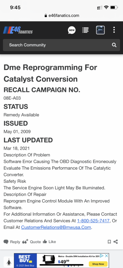

                            Also keep in mind there’s a DME recall on ‘02 cars... not sure if yours has had this work done yet. I'm not sure if they're related by I'm sure you should be sure...
