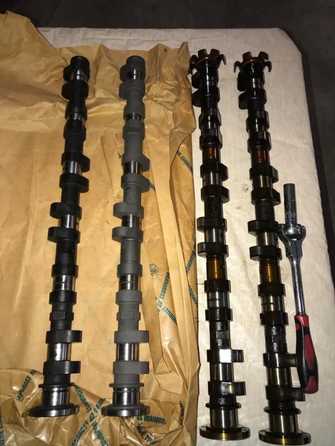

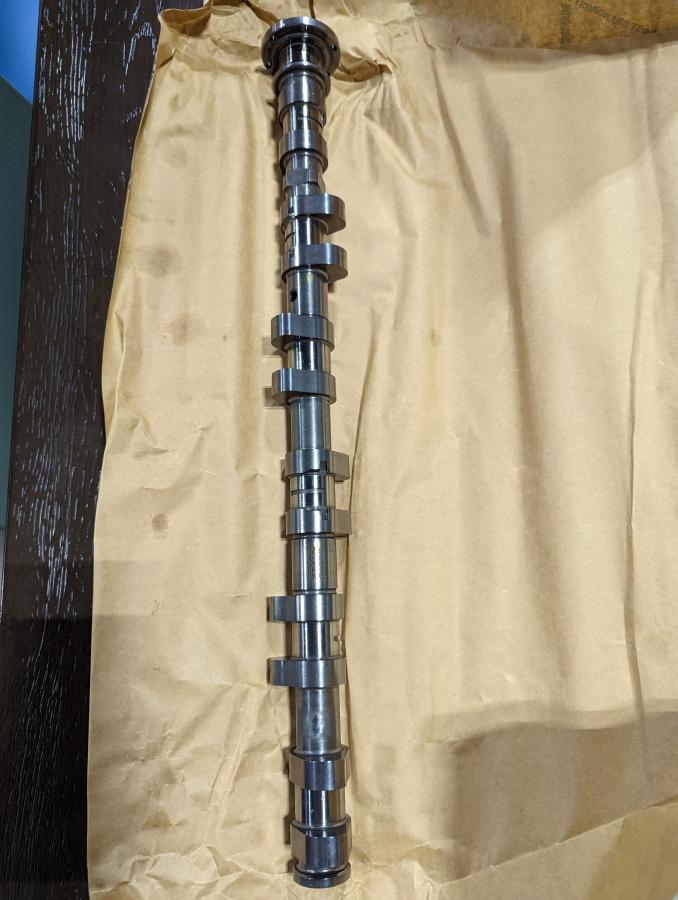

    I'm aware of 4 variants.
    Original - See the picture from Obioban's thread below. Cam looks near identical to BMWs, appears to have been ground from the same blanks. Standout features compared to newer Schricks - hex area to turn the cam is smaller diameter than the shaft, and the flat surfaces of the lobes have a textured finish to them
    The rest seem to be variants of what turner calls the new "cast" cams. There seem to have been two variants of the coating, a black one and a light gray one. And now an uncoated variant. All pictured below. Unclear if metallurgy changed during those transitions, nor do I know what the coating is actually made of. Visually asides for the coatings or lack thereof, you can see the hex area is larger diameter compared to the shaft, and the lobes have a smooth finish on the flat surfaces where BMW's and the "OG" have a textured finish. Looking it up, I think the 'coating' is a result of nitriding the cams, still not sure what the significant of black vs grey would be, but that could explain why the 'uncoated' ones seem to be failing - they don't have the surface hardening that is expected.
    Click image for larger version  Name:	AB3EB181-1A80-4BCD-9119-E397304E8150_1_105_c.jpg Views:	330 Size:	85.9 KB ID:	222597​

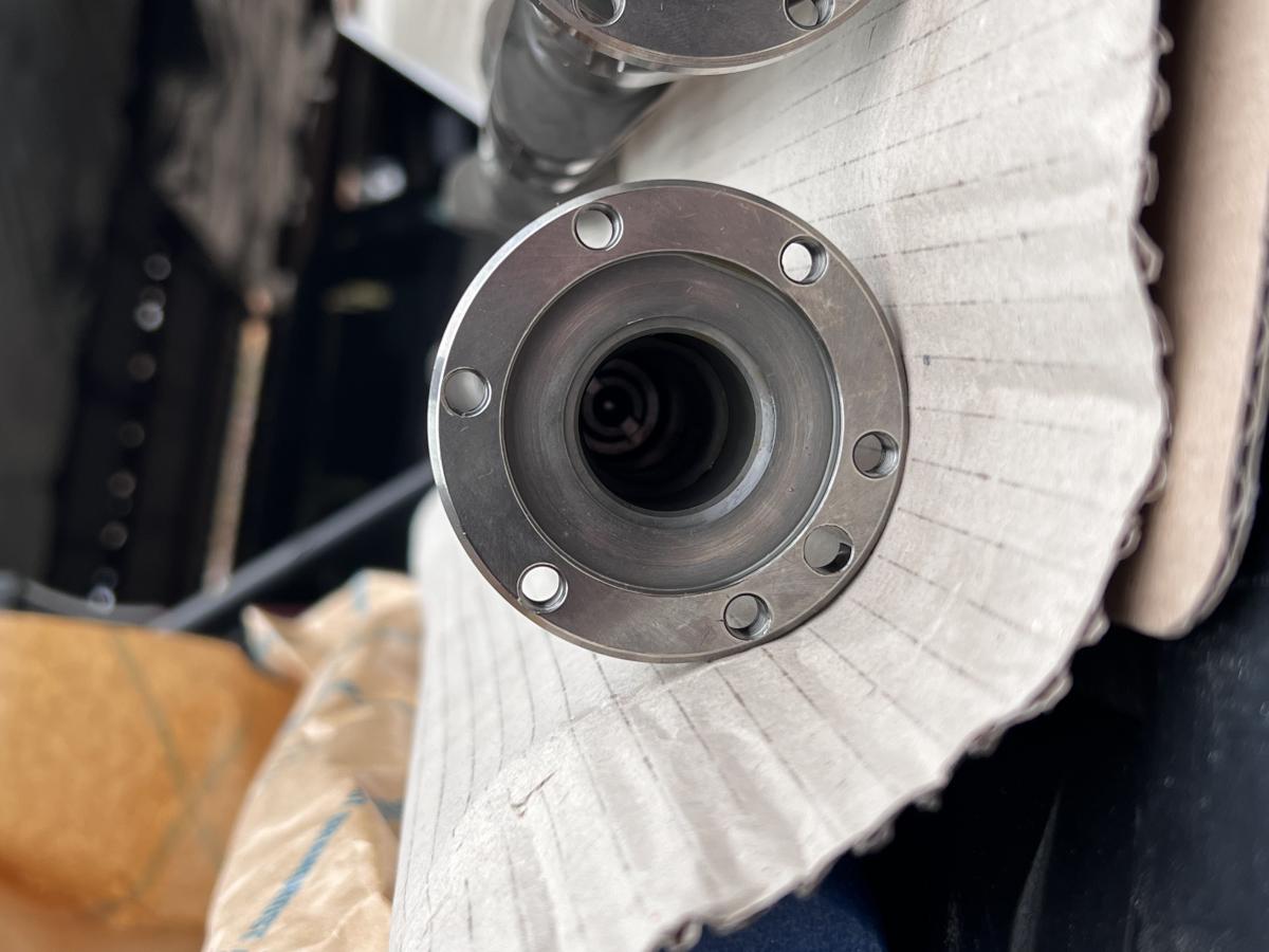

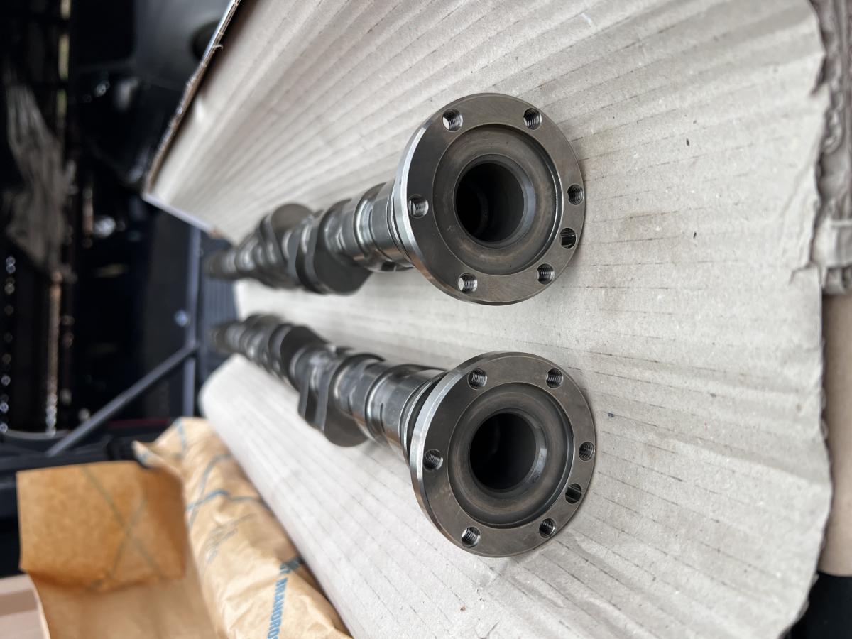

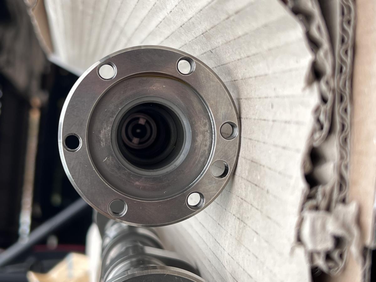

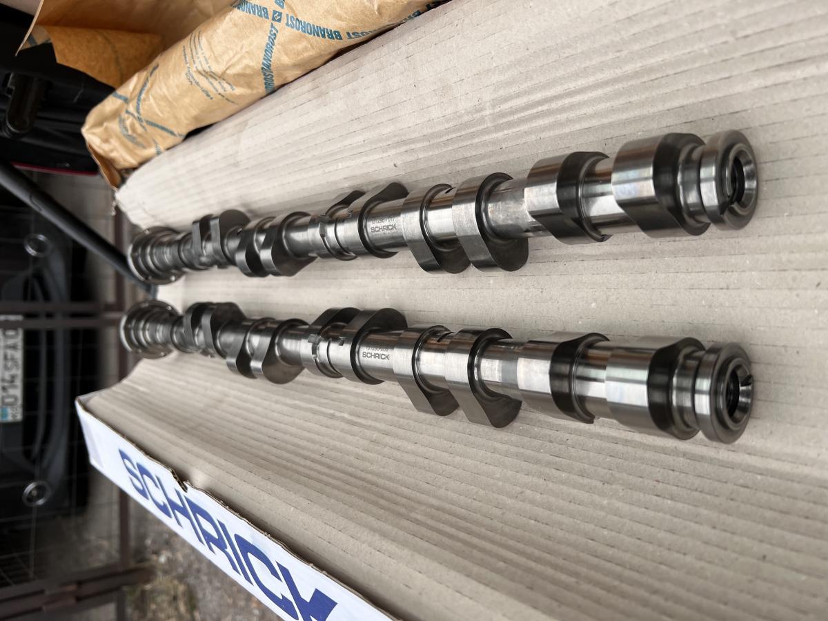

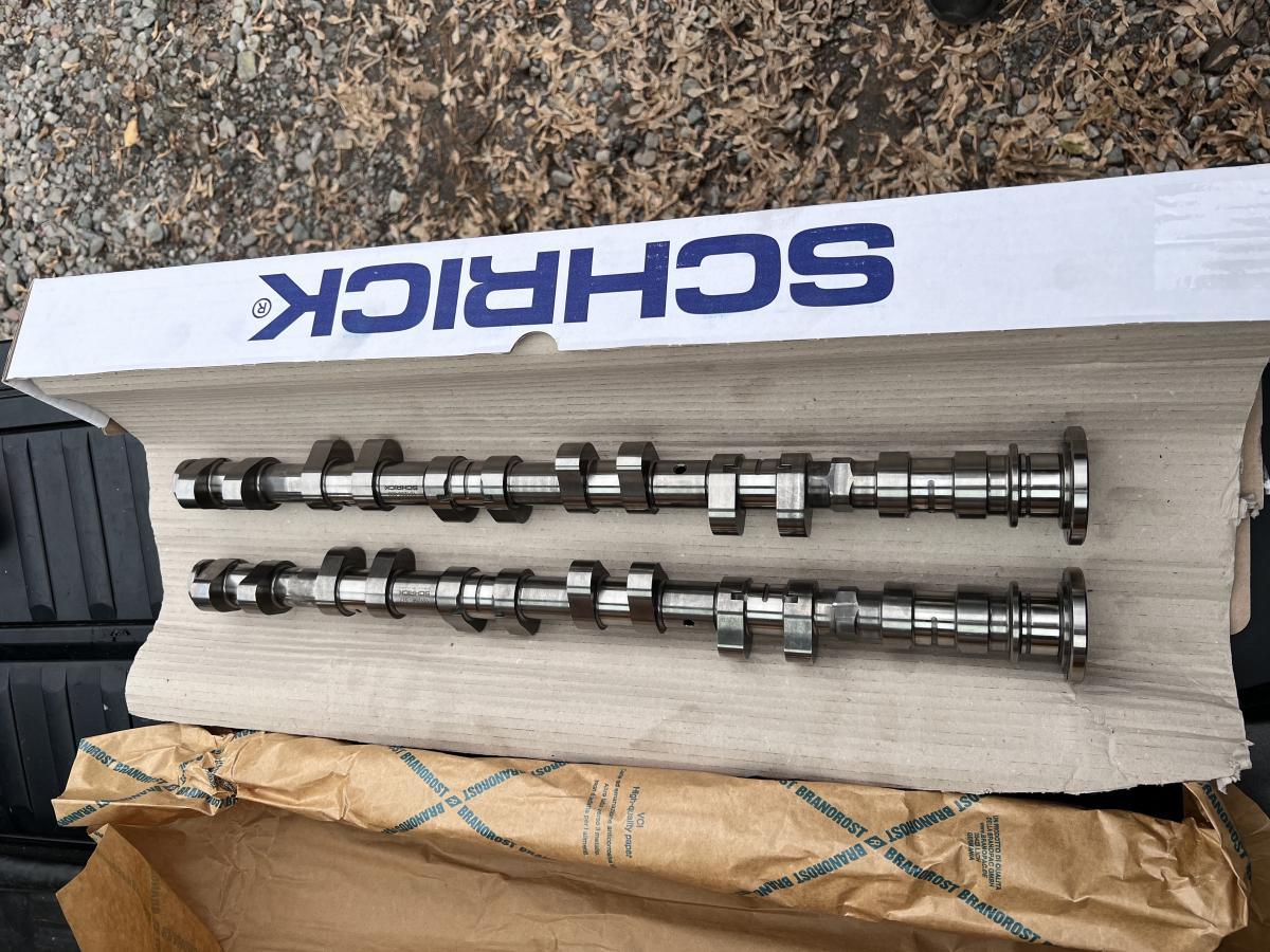

            I have a set of these older 280/272 Schricks cams

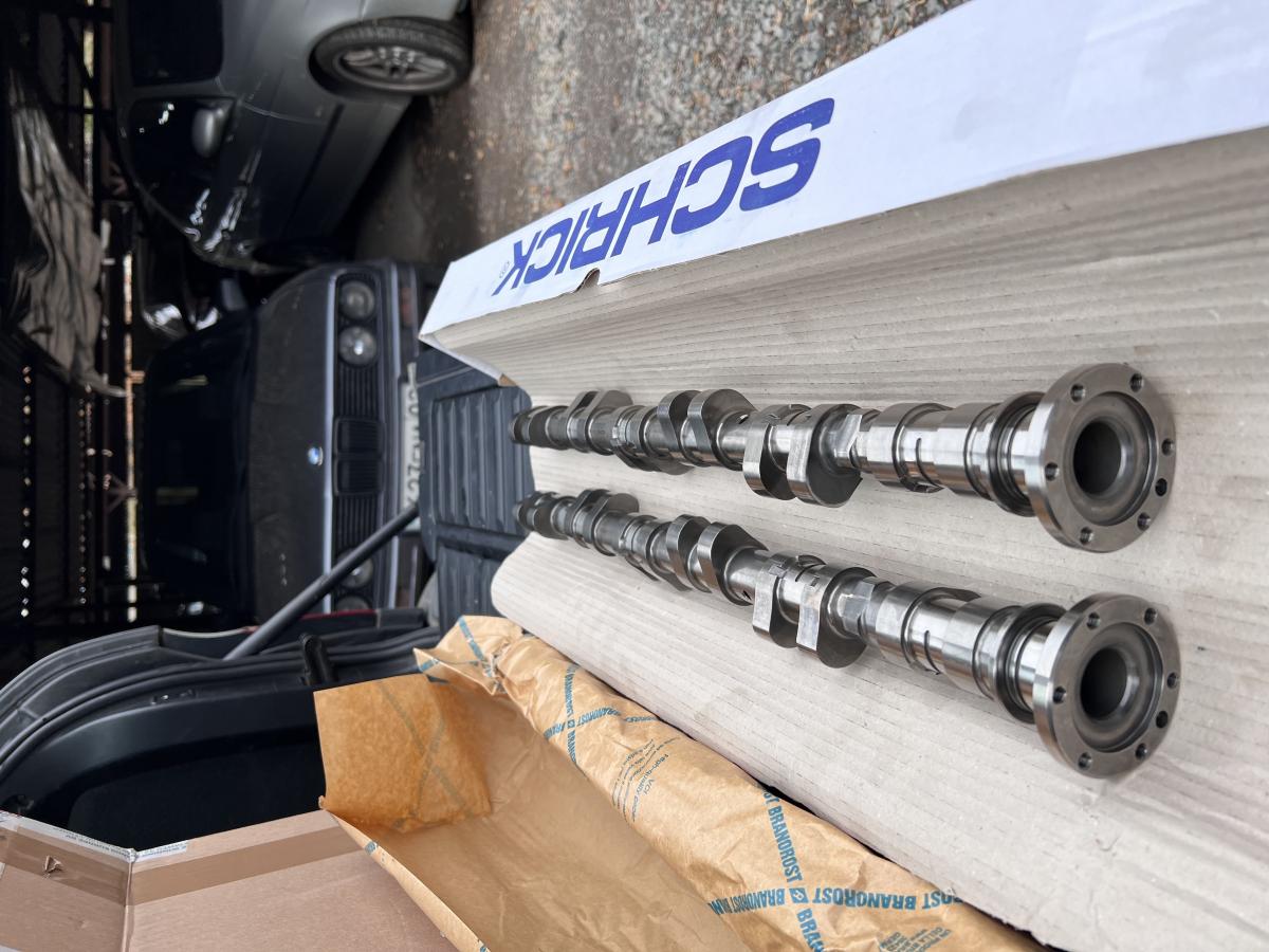

              Which mileage on it? Dlc almost gone at working surface. I've bought schricks in 2022 and they already was without black coating.

                about 40000km

                  Did these require the DLC rocker arms?
                  What did you use when you installed them?
                  Why were they removed after 40,000km?
                    I assume that your cams definitely require the DLC rocker arms vs the black coated cams?

                      I removed them from a car I bought 2-3 years ago and sell the car after removing all mods from it. They were installed with OEM followers.
                      They were installed at 42000km and bought the car with 82000km.
