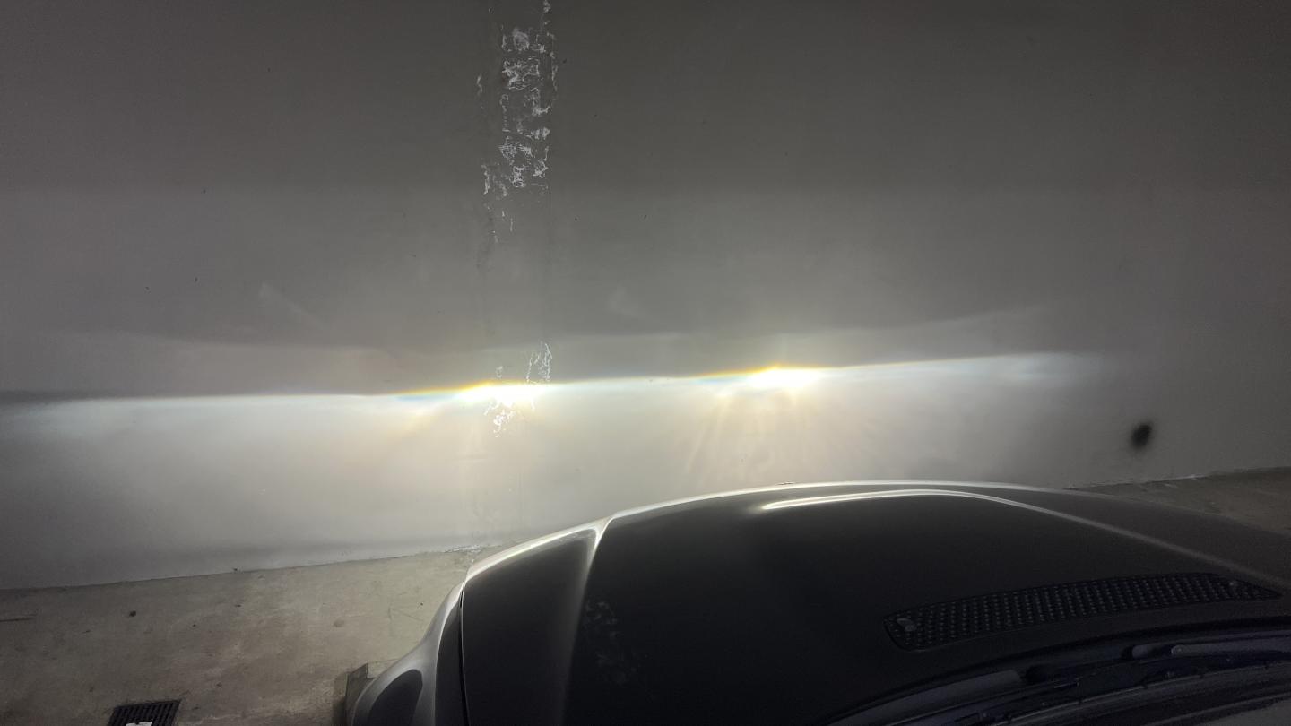

    This is what's happening (look at the right headlight color and flicker) -
    What I want -

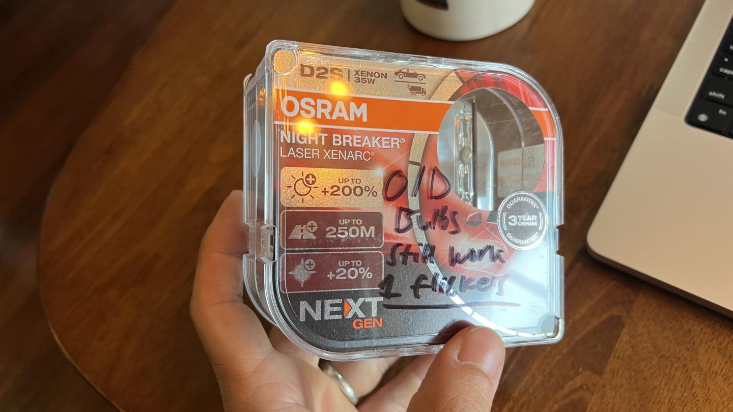

                Stock ones I pulled from the car - Osram Xenarc 66040
                These are the ones I went with off Amazon - Osram XENARC NIGHT BREAKER LASER D2S, Next Generation
                Paid $128.99, and here's the listing that I bought them from - https://www.amazon.com/dp/B0BBNDS5KR...fed_asin_title
                I bought these on Amazon of course after seeing the last post from c watson - but now I'm suspicious however if I bought reps, take a look at the photos from the box, and I'll pull the driver's side bulb to take some photos of the actual bulb itself as well so you guys can see.
                What do you think?

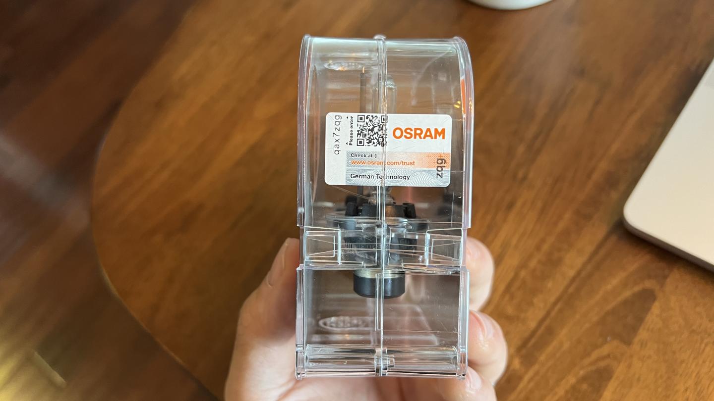

                Authenticating the lights - well, I learned today that you should really read the damn box as it's all there for you to verify - here's my discovery so far -
                This seal on the side was sealed, I had to cut it with a knife to open it - I don't have photos of the bulbs themselves but can pull one to check

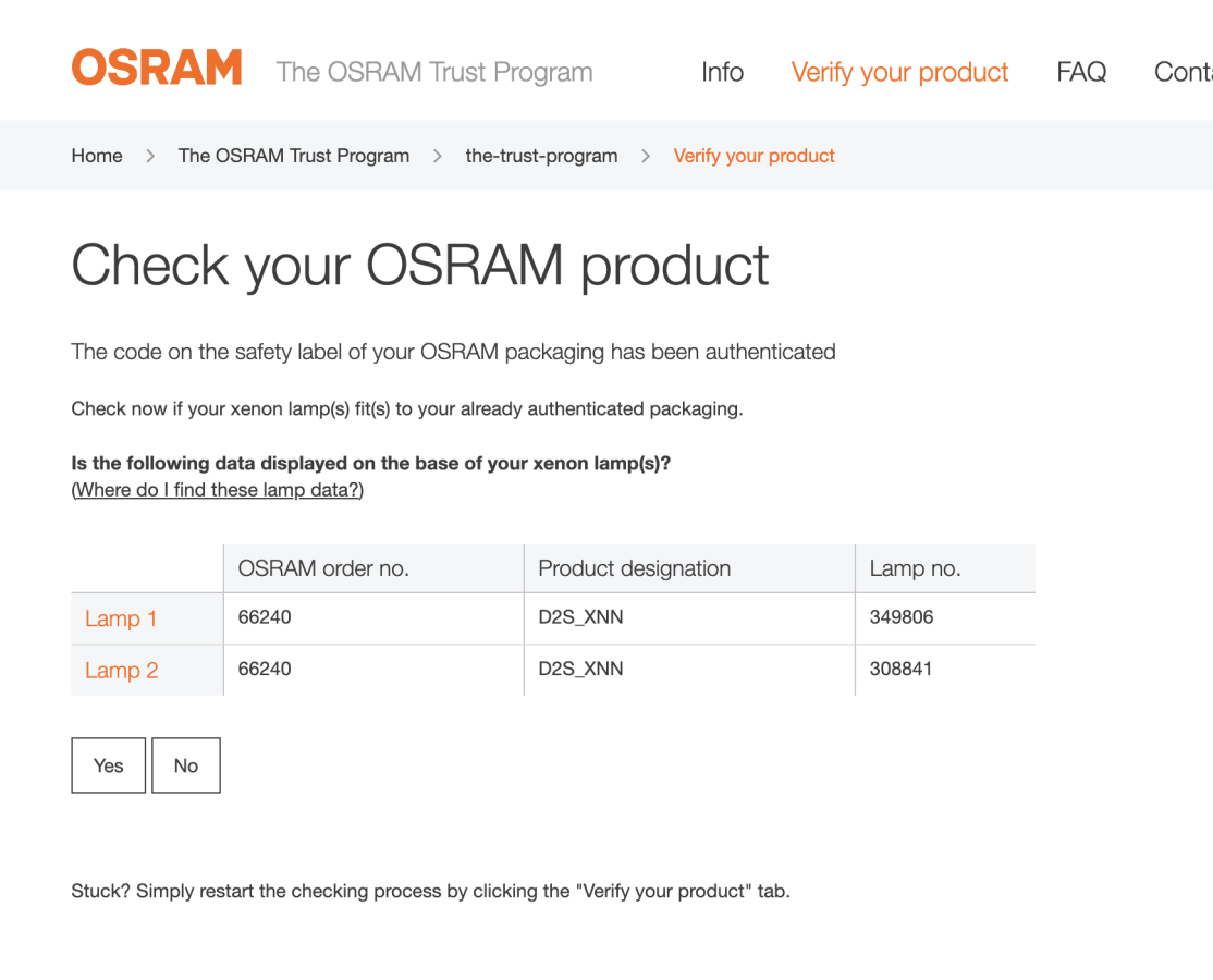

                I entered the 7 digit code on their website and it came back with a positive result for the box - now I need to go verify these numbers off the bulbs as I forgot to do this before putting them in haha but I'll do that quickly and report back
                Click image for larger version  Name:	Screenshot 2024-08-29 at 9.20.03 AM.png Views:	0 Size:	164.7 KB ID:	277109

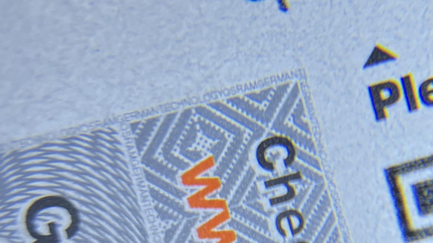

                Also verified that the secret OSRAM logos are there on the box with my loupe, you cannot see this by holding up the box, really crazy you actually have to get a magnifying glass or loupe to see them
                Click image for larger version  Name:	IMG_2054.jpg Views:	0 Size:	106.9 KB ID:	277110

                BEFORE - The discoloration in the passenger side light can really be seen here

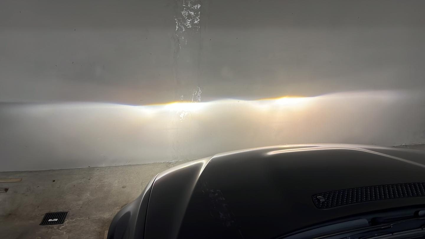

                AFTER - One note: the passenger side light seems to have some distortion under the main beam, see the second photo to really see it - I'm guessing this could be the glass housing of the headlight itself? I think that maybe with the previous bulbs it didn't show up as prominent because the bulbs were dimmer?
                Click image for larger version  Name:	IMG_2027.jpg Views:	0 Size:	54.5 KB ID:	277104
                Click image for larger version  Name:	IMG_2029.jpg Views:	0 Size:	44.2 KB ID:	277105
