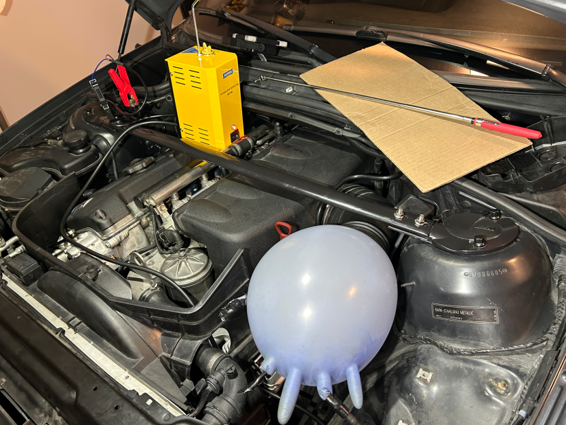

        To OP, I am also in the same boat as you, my LTFT is 20% for both banks and no CEL, my STFT is very normal (well under 4% while driving), this is usually a sign of vacuum which I have been chasing this year !
        I replaced these components:
        1. injectors
        2. all injector / air rail O-rings
        3. fuel pump
        4. new intake elbow gaskets x2
        5. PCV cyclone with new o-rings & gasket
        6. valve cover gasket
        smoke test shows no leak, so now I suspect all the plastic vacuum hose that connects to the airbox and brake booster.
            1. injectors
            3. fuel pump

            Yikes, that’s no fun. I’ve replaced all of those too except the pcv and fuel pump with no change. Haven’t done a proper smoke test yet but it may be time. Good luck!

                    high fuel trim are most likely:
                    fuel pump failure
                    clogged injectors
                    vacuum leak - I highly suggest you check thoroughly all the flimsy plastic tube / hose that goes into and out from the airbox, particularly :
                    1. PCV ventilation hose return to airbox
                    2. 90 deg tube that goes to oil dip stick
                    These are the common area of failure for vacuum leak
                      fuel pump failure
                      clogged injectors
                      Had injectors serviced recently and have had the airbox out when doing it and inspected everything under there which is why im leaning towards my fuel pump. If it for some reason doesnt solve it ill do a smoke test.
