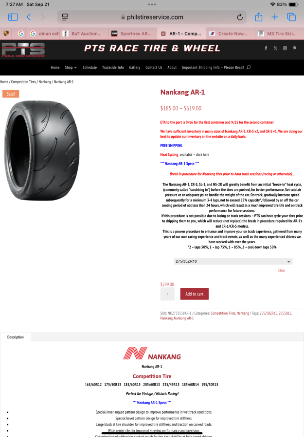

    Looking to move up to a more aggressive tire for track days, currently use Hankook RS-4. Heard good things about the AR-1. Any feedback on these? My 04 has Ohlins R&T and an aggressive alignment (-3 deg camber). I have ARC-8 18 x 9.5 wheels. Any concerns fitting 275/35-18s? Thanks.
