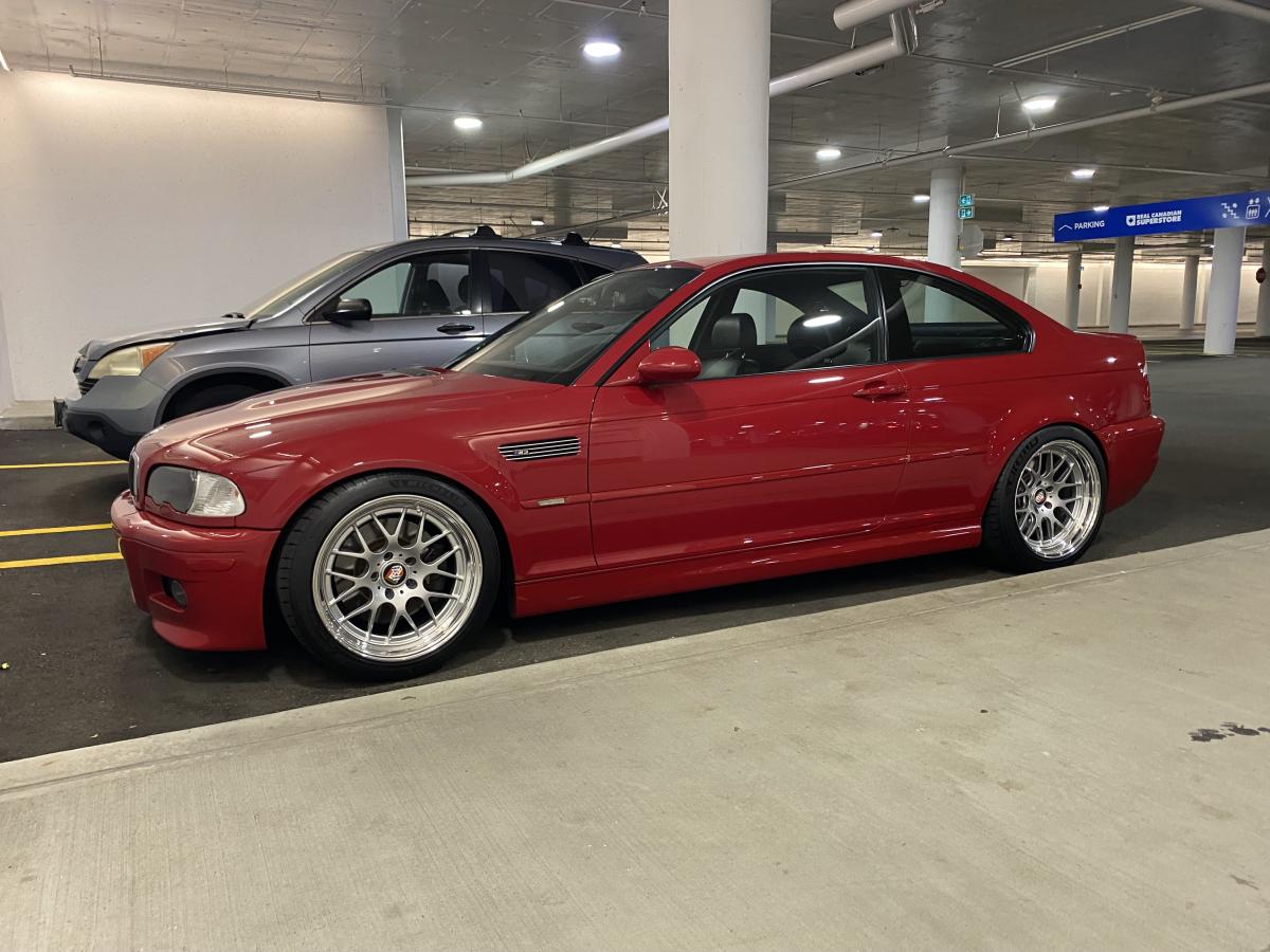

      I’m running 18x9.5 front and 18x10.5 rear with 265/35/18 and 285/30/18 rear. Had to shave the rear fenders to eliminate rubbing. Click image for larger version  Name:	IMG_4242.jpg Views:	73 Size:	134.6 KB ID:	280711

            Those wheels look great. If I had the 9.5 in the front, then the 265 would be a no-brainer.
