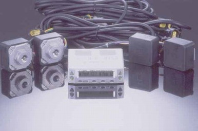

      Are there any kits that offer electronic control of damper rates?

        This is a throwback, but Tein might still make the EDFC module that was compatible with their coilovers and it allowed you to change the damping on the fly.
        ModBargains.com offers EDFC TEIN Electronic Dampening Force Controller and much more for sale. Shop online or order today at 714-582-3330. In Stock, Ready for Fast Shipping.
