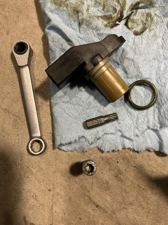

          I had to buy that tool to get that thing out, and I nearly rounded the 5mm hex while doing it and I ended up using T30 to get it out, otherwise it turns to a nightmare
          The trick is to make sure your 5mm hex is perfectly deep inside and perpendicular ( I know this is hard at the back of the engine, but you have to be 100% sure they are, otherwise you'll end up like me)
          Honestly, I have no idea why BMW decide not to use bolt
          ​Click image for larger version  Name:	IMG_6838.jpg Views:	0 Size:	131.5 KB ID:	281501​​
            I thought about changing he screw to a bolt, but I am a sucker for specialty fasteners and like torx a lot :P
