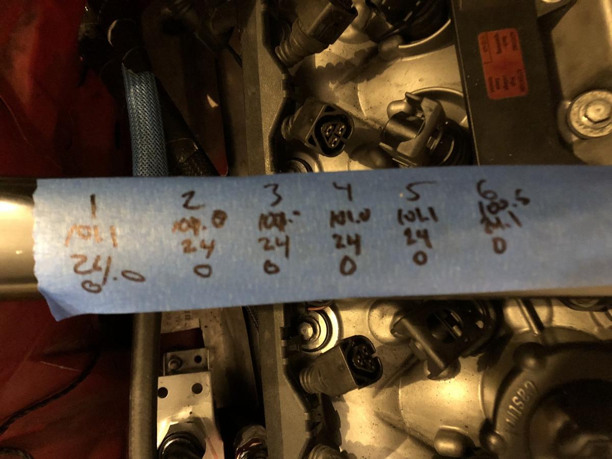

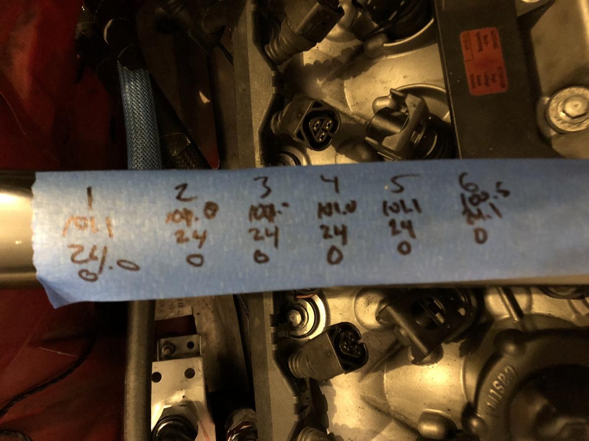

            You can try resistance testing the coil harness with it connected to the DME to ground. There are 3 leads. Each position should have the same resistance across the 6 coil plugs. If there is one that is different, then unplug the ECU. Resistance test end to end for each wire - you'll get a different number since you're only testing the resistance of the wire. If there are no differences between the wires the its the ECU.
            I had a persistent cyl 6 misfire..took 3 months but finally tracked it down.
            My theory is I had a bad coil, kept driving it and it f'd a MOSFET on the ECU. The coils are all wired together...IIRC...the ground is in series and the other 2 leads are in parallel. So if I coil goes bad, you get a different final resistance at the ECU with cause sensitive electrical components to fail. Like a MOSFET.
