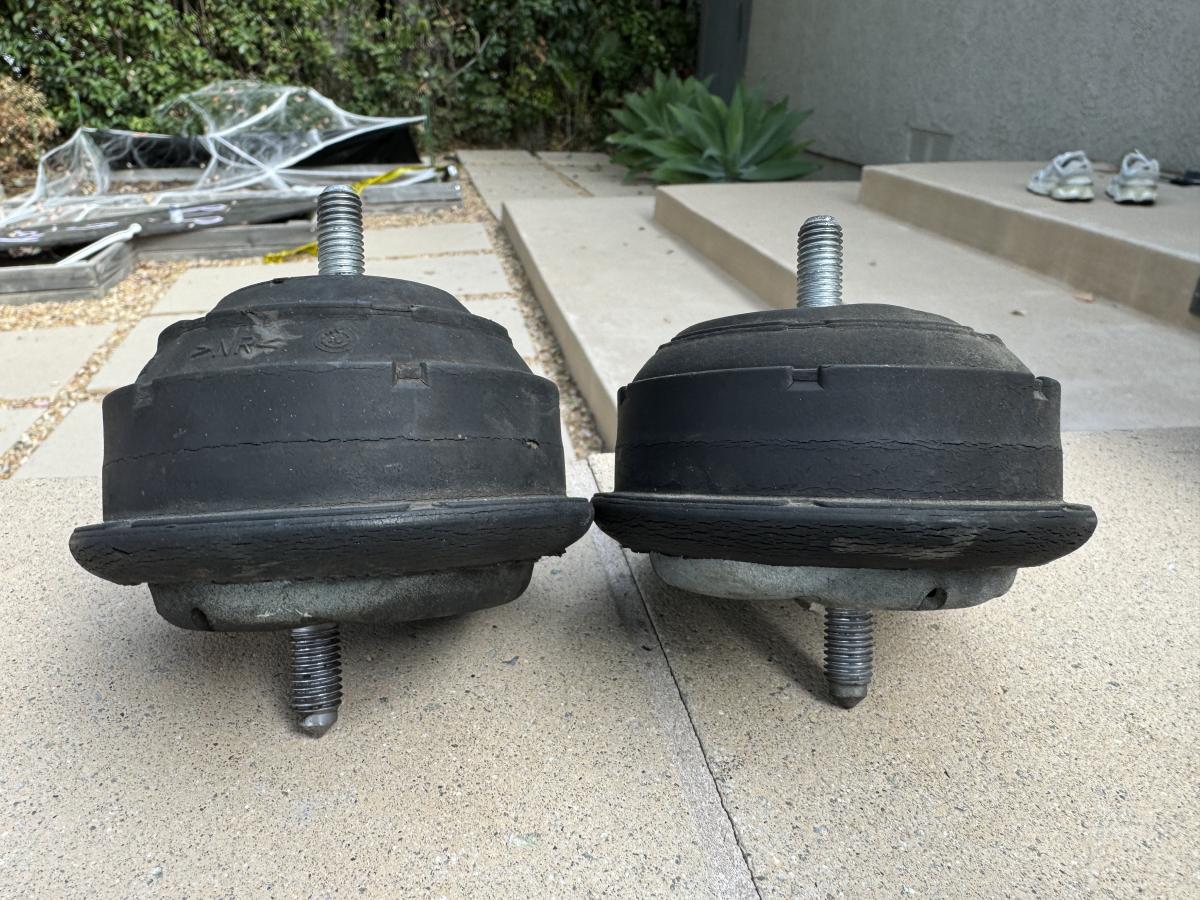

I switched out my engine mounts this past Sunday in my garage on jack stands for the first time. Car is 2006, I got it a little over a month ago and has close to 120K on it. I don't think they've ever been changed based on the way they look, see pic. I've done them before in my father in laws shop on a lift, this was a while ago though on my 2004. Watched a few videos on how to do it to refresh my memory and almost every single one said the passenger side is more difficult until I watched the FCP Euro DIY.
