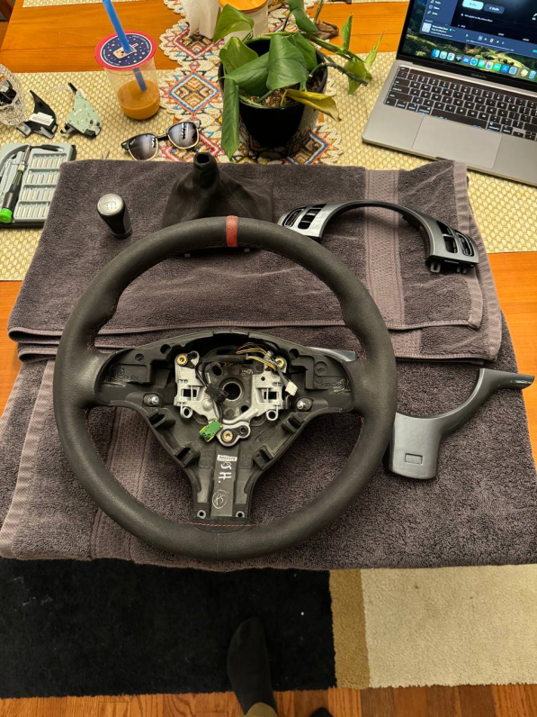

    Hey all! I haven't been active on here much but y'all may remember me from m3forum.net (RIP). Back in the day, I had gotten my steering wheel rewrapped in alcantara by Coby Wheel and over the years it's collected a wonderful cocktail of dirt, hand oils, and 7-11 taquito grease. I recently took all of my alcantara bits out of the car for cleaning and while I was at it, I decided to restore my god-awful trim pieces to something close to OE.

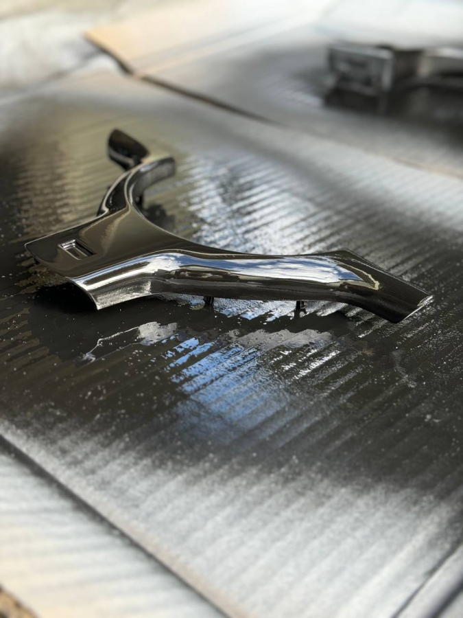

    So I decided to try satin black and a matte clear coat. To be honest, it's been a very long time since I've seen an OE steering wheel trim piece so I can't really gauge how close to OE my finished product is. I do know, however, that I really like the way it turned out!

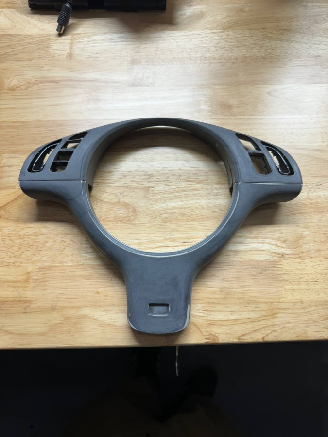

    Before (notice the glossy steel-gray trim):

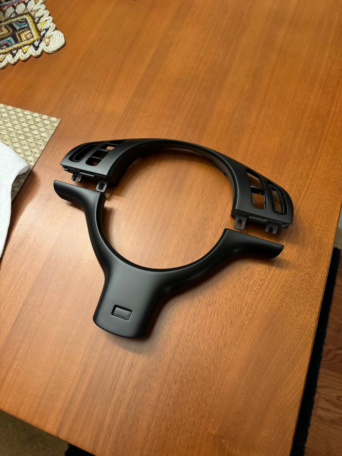

    And the results:
ID:	285009Click image for larger version

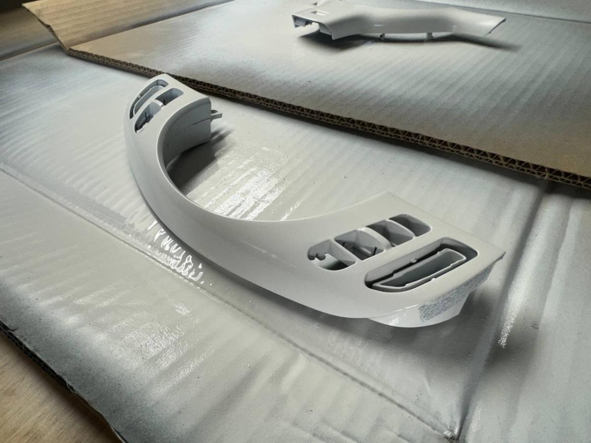

    2. Apply primer. I used Rust-oleum Painter's Touch 2X UltraCover Flat White primer. If you see imperfections in the primer, those will show in the final result so go back to sanding and reapply your primer. Let the primer fully cure before moving on.

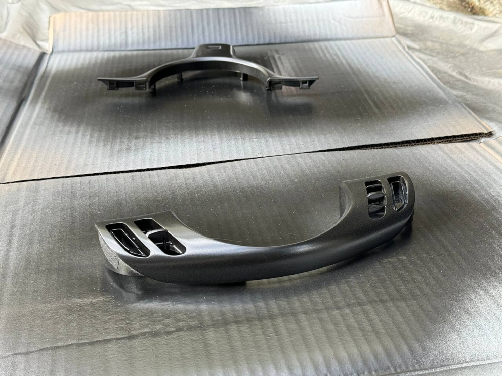

    4. Apply clear coat. I used 2 light coats and 1 medium coat of Krylon Matte Finish 1311 clear. I think if I added another coat or two, I could have brightened up the black ever so slightly. If the finish looks too dark, consider giving an extra coat a try.

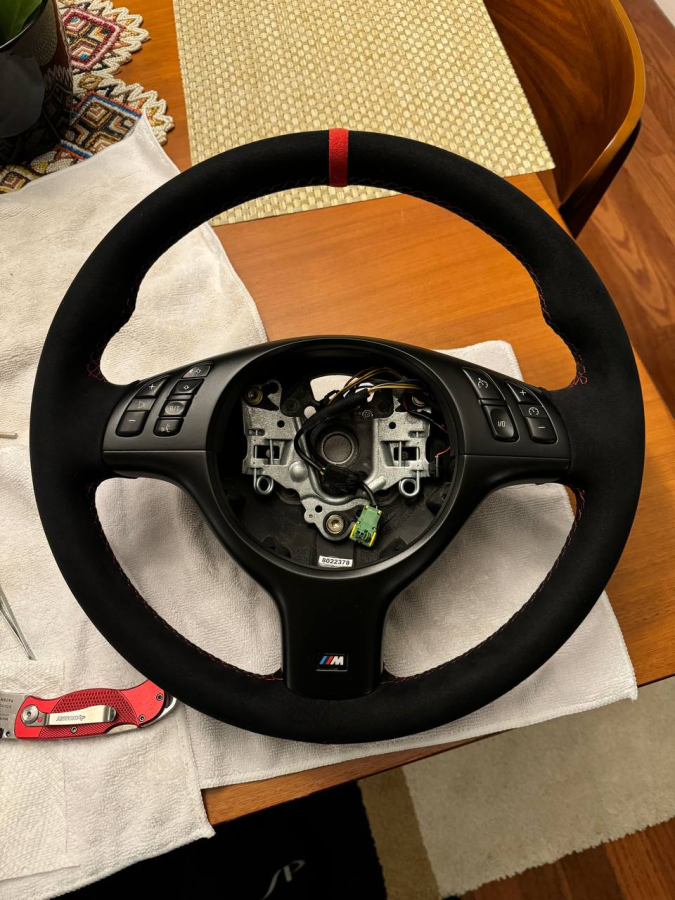

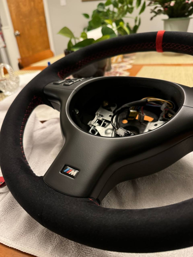

    5: Admire! Then put it all back together. I opted to wash my buttons with warm soapy water and a plastic brush. I got a pack of 10 ///M stickers off Ebay many years ago and a little trimming allowed me to use one for this project.

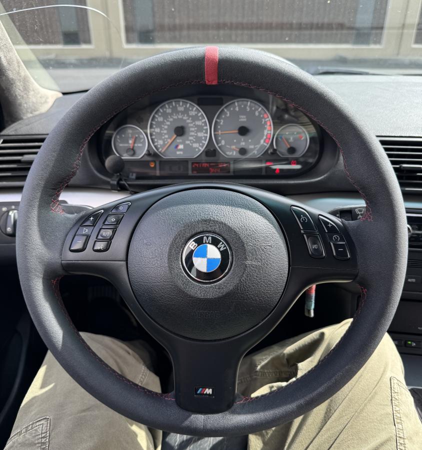

          1.5 years and almost 10k miles later, the steering wheel trim still looks the same as when I painted it! Really happy with the results. The alcantara is due for a little TLC, though. 😆
