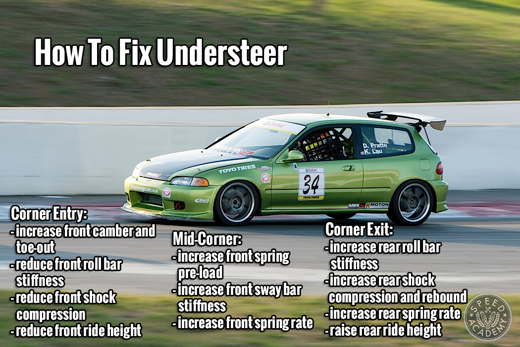

                      Click image for larger version  Name:	Suspension-Cheat-Sheet-03.jpg Views:	0 Size:	512.0 KB ID:	28874
                      The above mid corner section is only half complete, imo-- softening the opposite end of the car will have the same result.
                      But, if mid corner is where your issue is, camber isn't going to help-- you need to decrease rear grip or increase front grip by making the front softer and/or the rear stiffer, be it through sways or springs.
                          Right on thanks for that graphic. Maybe I'm getting understeer but slightly in the entrance. All I know is the car is handing worse after my dealer tech friend aligned it to bmw spec. So my guess is camber and toe out where playing a roll in it handling better before the alignment. Pre alignment or was - 1.8 and some toe out up front and - 1.5 rear. After alignment it's much closer to stock spec - 1 up front -. 8 in the rear
                          Or maybe it's handling better and I'm going faster but from my glances at the gauge mid corner that doesn't seem to be the case.
