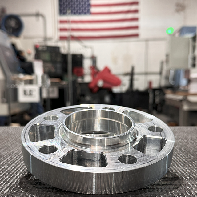

    I found a company that makes custom spacers:
    5x120 mm hub-centric BMW wheel spacers with a 72.56 mm hub bore fit models like E24, E28, E30 M3, E31, E32, E34, E36, E38, E46, E60, E63, E82, E83, E87, E90, E91, E92, E93, F01, F02, F06, F07, F10, F12, F13, F22, F23, F25, F26, F30, F31, F32, F33, F34, F36, and F87. They correct wheel offset and prevent interference.
    Seems like they would work and they are made in custom sizes while being affordable. They also have material cutouts reducing weight and the hub groove for easy removal.

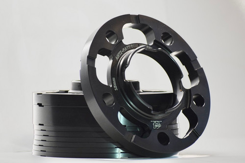

                      These Core4 spacers have a cutout in the middle to prevent fatigue on the bolts/studs:
                      PRICE IS PER PAIR (quantity of 1 in cart = 2 spacers) Introducting our "Anti-Fatigue" hub-centric slip-on wheel spacers for 5x120 BMW vehicles with 72.56mm diameter wheel hubs. Available in 5mm, 12mm, 15mm, and 20mm thicknesses. WHY ANTI-FATIGUE? Never worry about wheel center-bore chamfer interference due to manufacturing differences of wheel brands. Interference at the center can stress wheel studs significantly. The mating surfaces of the spacers ensures the that the center of the wheel stud clamping pressure is outside the wheel bolt circle - i.e.- increases friction leverage to resist shear loads (braking, engine torque, corner weight, etc.) from being imparted onto the wheel studs (BAD!). Hub-centric for OEM wheel alignment with the rotation axis of the wheel hub/bearing (except 5mm which is thin enough to keep the wheel hub hub-centric feature) OTHER FEATURES: 6061-T651 Aluminum Alloy Mating surfaces held to 0.001in (0.025mm) or less parallelism and flatness Pry notches along the OD on both sides for easy removal from hub or wheel Lightweight design Type II Black Anodized finish to prevent aluminum oxidation (white powdery build-up)
