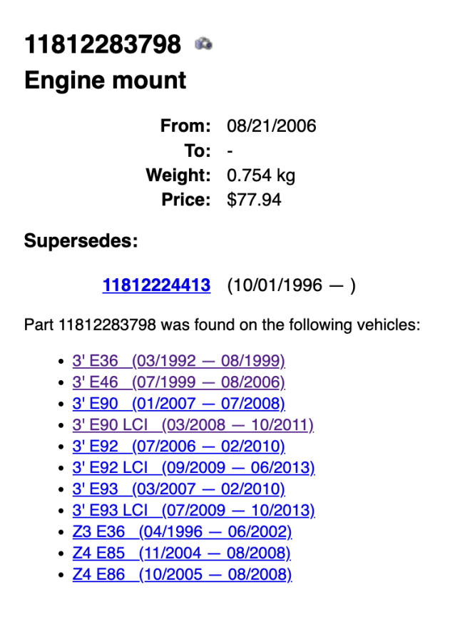

            E36, E46, E85/6 and E9XM all use the same part number engine mount now.

                Interesting find that they consolidated part numbers between E46 and e9x Ms. Apparently E46 xDrives and M3s also share mounts, huh.
