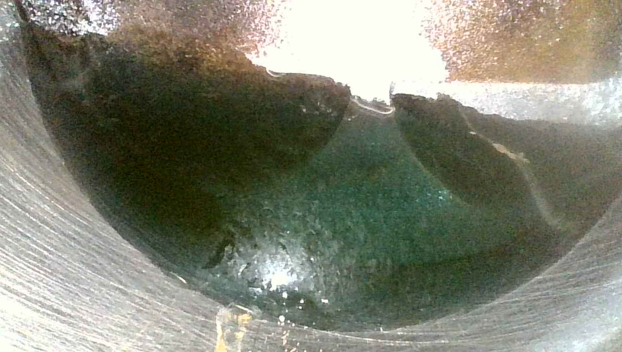

              Thanks All, Sadly, i have found coolant in cylinder 1. this is roughly 70k miles since rebuild.
