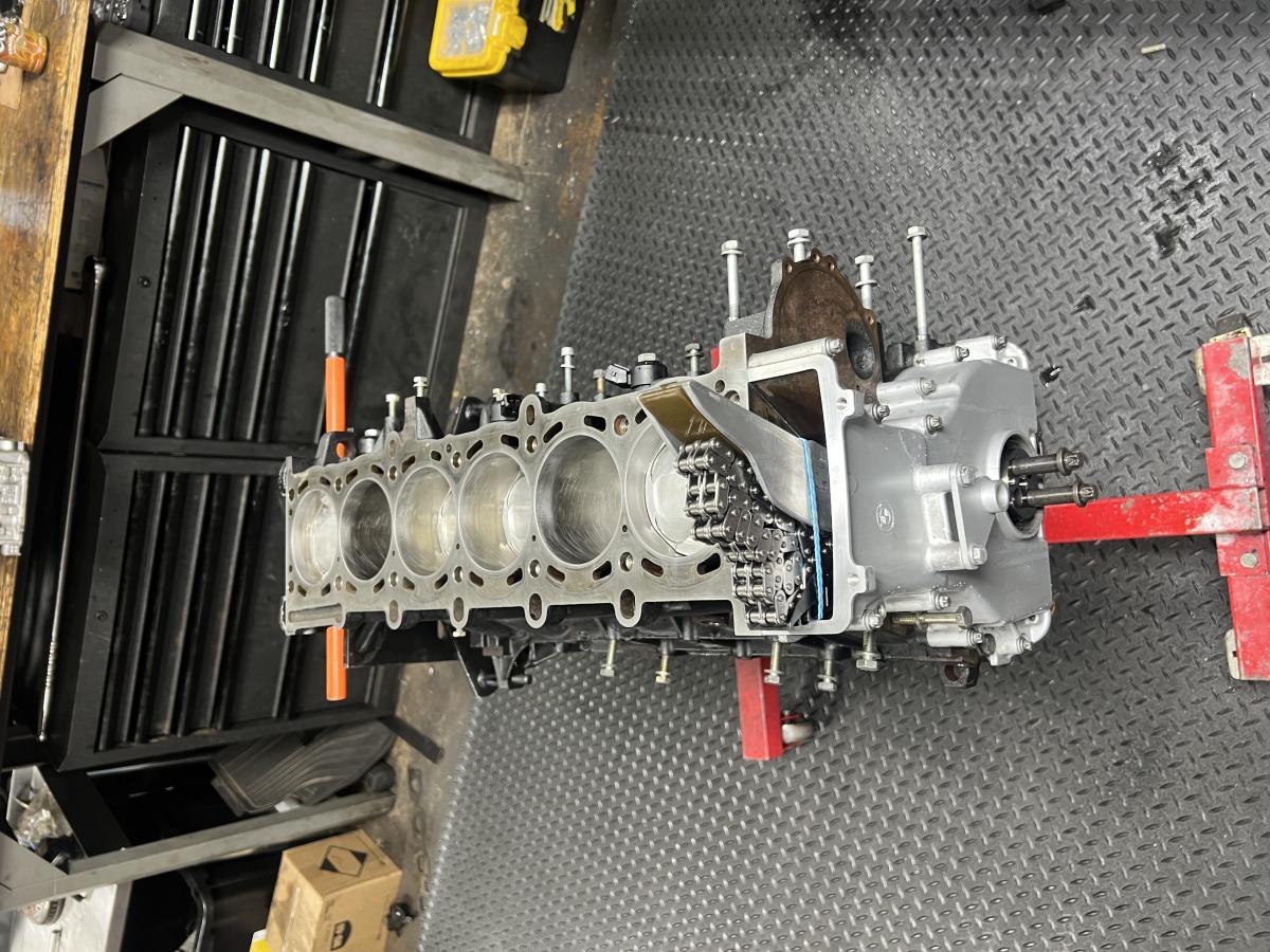

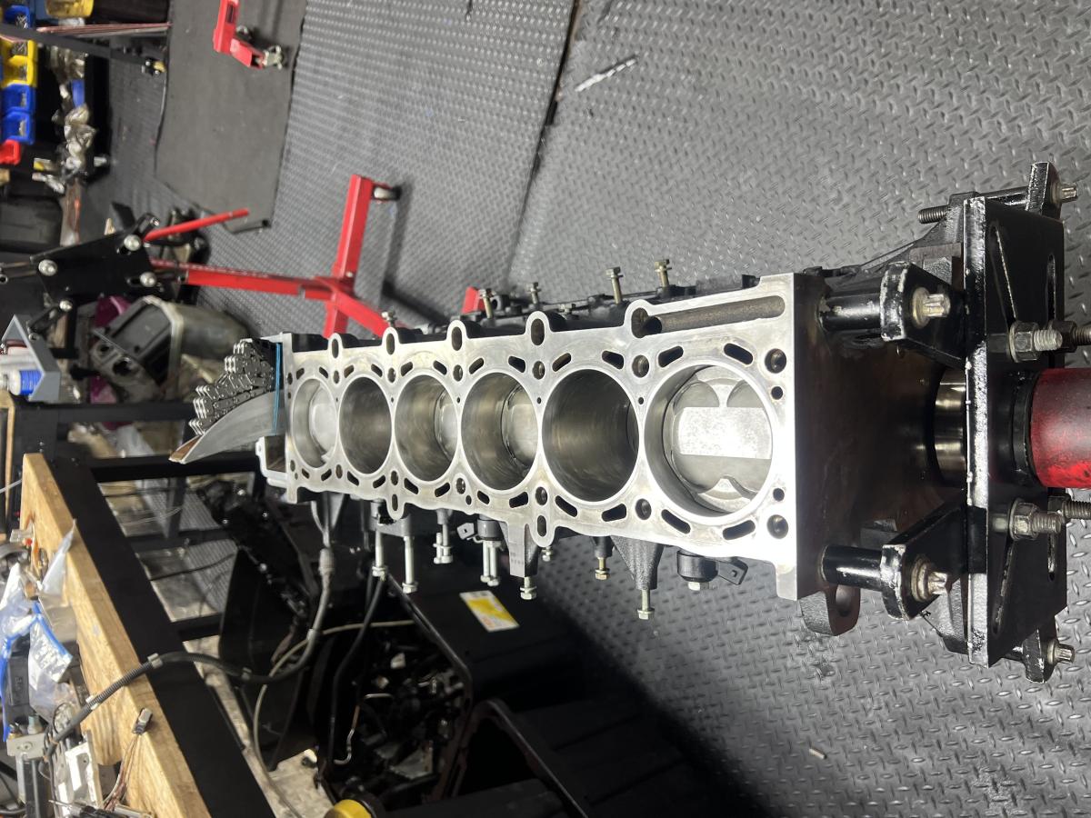

        I cleaned my head and block by hand. No machining, just measuring. Took me some time but wanted to do the job asap done. If I should do the job again I will give the head to a machine shop to look at all parts and machine the head.

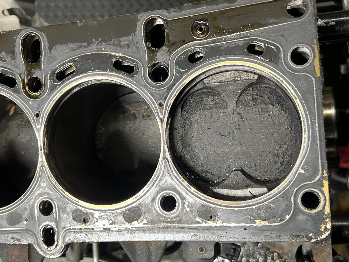

          I actually purchased the BMW special tool grinding stone, part #83300495104. Surprisingly it worked well all around. Used it for the block, both the head gasket surface and the oil pan gasket surface. Also used it on the head (ended up sending it out for a resurface anyway due to some pitting) and it cleaned up really well.

            Nice, did any material come off the grinding stone when using it on the block? Looking at the video, the stone has a few rough edges, so I guess it can chip if the corner catches an edge on the block surface.
            Where was the head pitted?

              Not really…surprisingly it almost felt like it just cleaned up without removing material both from the stone and the surfaces. I still would recommend a good wipe of the surface afterwards. You can also see it being used in Sreten’s video at the 41 minute mark.
              Disclaimer though, if you get the stone wet then it starts chipping off and material gunks up. Best to use this tool dry since it’s soft. I guess stone would be the wrong word, it feels like a solid sponge.

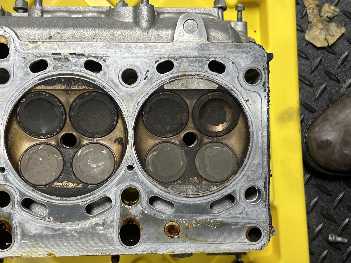

              Here’s a pic of the head and piston…piston was slapping. Even after cleaning with the “sponge” you could feel the pitting. Figured cheap insurance to just get it machined.

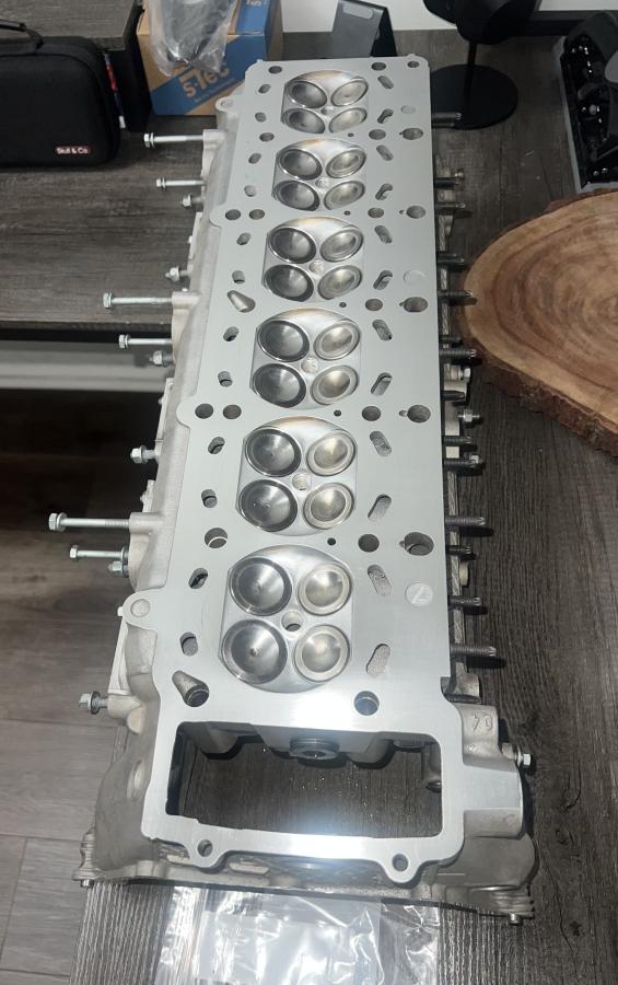

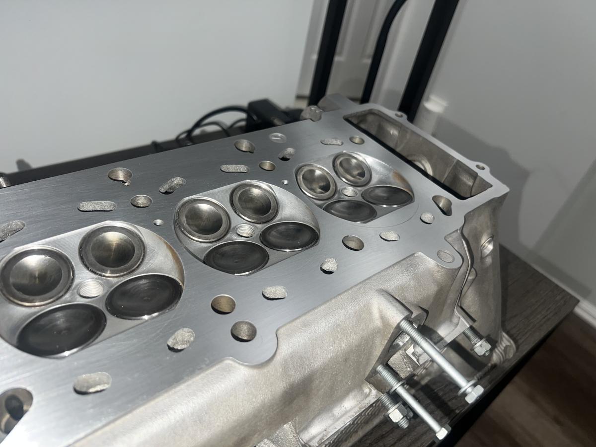

                          Head is back from Machine shop, they machined 6 thou off,
                          It's game on!!!
