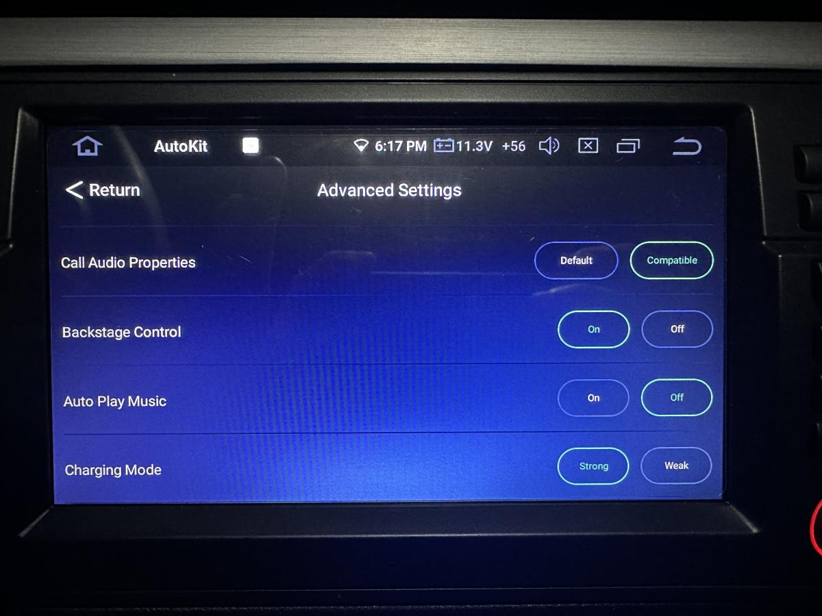

        Bry5on​ so I was mulling over what you found inside the unit, and think there might actually be a software workaround to use an external mic while retaining CarPlay.
        Like Mayan-Viking I was also puzzling over the dual connections to AutoKit and Car-Kit networks.
        Within the AutoKit app settings on the unit, under advanced settings there is an option for "Call Audio Properties". When switched to "Compatible", incoming / outgoing calls get directed through the head unit's built in caller that uses the Car-Kit bluetooth, rather than going through the CarPlay dongle which only has access to the internal mic. So contrary to what AVIN suggests about not using that network, the design flaw/oversight could possibly be used to one's advantage if connection to both networks is retained, allowing access to the external mic connection.
        This configuration seemed to work just fine in the test calls I did, but stability-wise I don't know how it will affect the other functions as the AutoKit software is a finicky POS. At the very least, you would still have to switch the audio device on your iPhone each time to Car-Kit, as it understandably wants to default to CarPlay for everything.
        Seems promising enough that I might try that external mic to see if the reasoning holds.

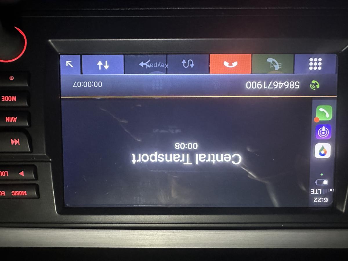

        Not sure why the second photo is upside down, but it shows how the unit is using the built in phone app.

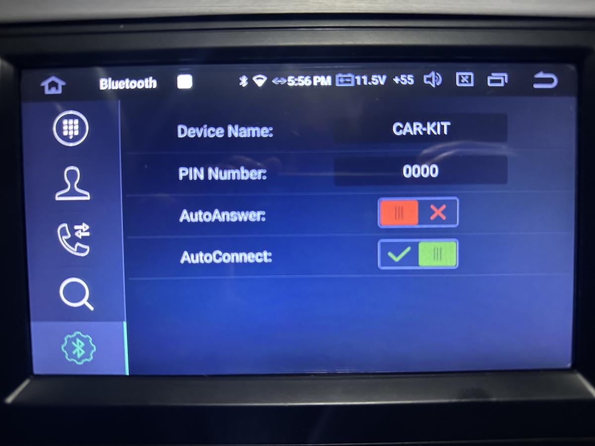

              Car-Kit is just the default name of the unit's built-in bluetooth network. If you go into the AVIN's app with the bluetooth icon the settings panel looks like so:

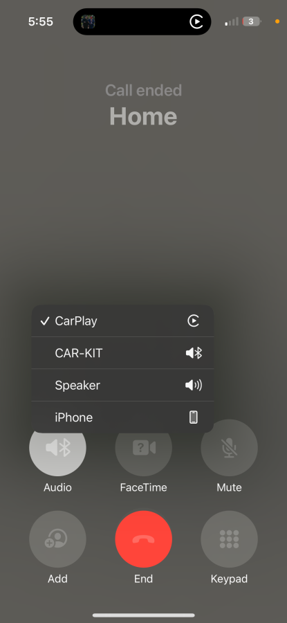

              My iPhone now recognizes Car-Kit and AutoKit, so upon starting up the unit the sequence that happens automatically on my phone is:
              1. Connects to AutoKit via bluetooth to establish Carplay
              2. Transitions to AutoKit via Wi-Fi (which is what Carplay runs on), and subsequently drops the AutoKit bluetooth connection
              3. Connects to Car-Kit bluetooth
              From this point if a call comes through and I want to take advantage of the built-in bluetooth over the dongle Carplay connection, I'd switch audio devices on my phone similar to if you wanted to put a call on speaker.
