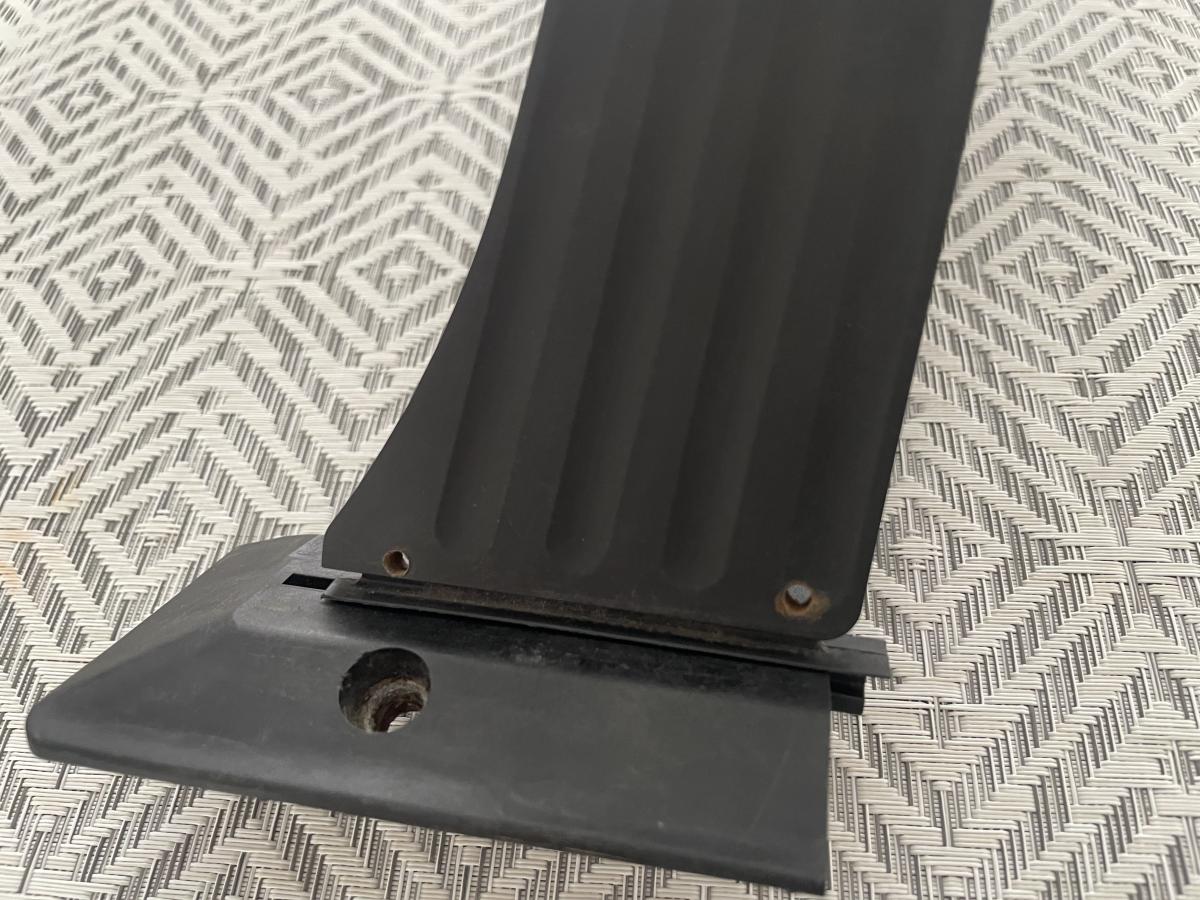

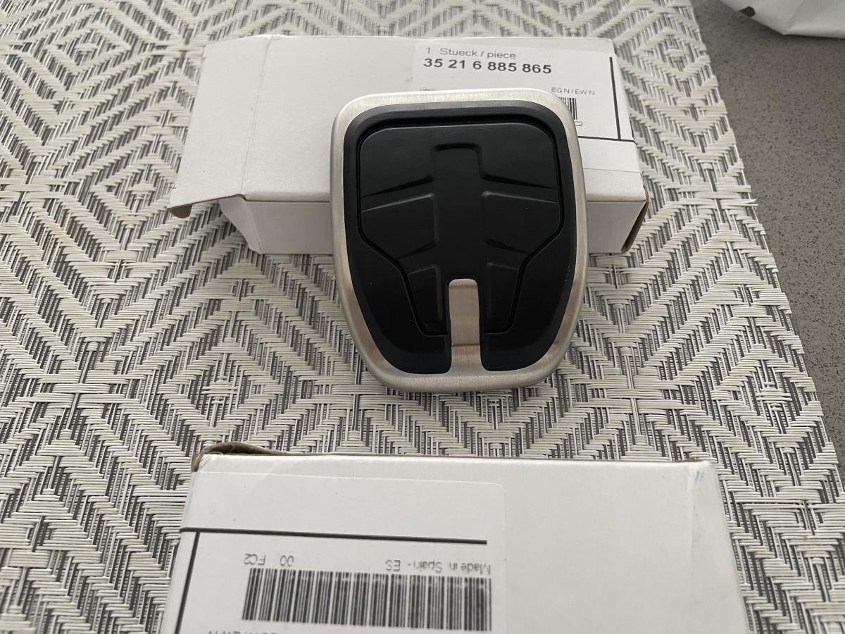

        Here the pedals

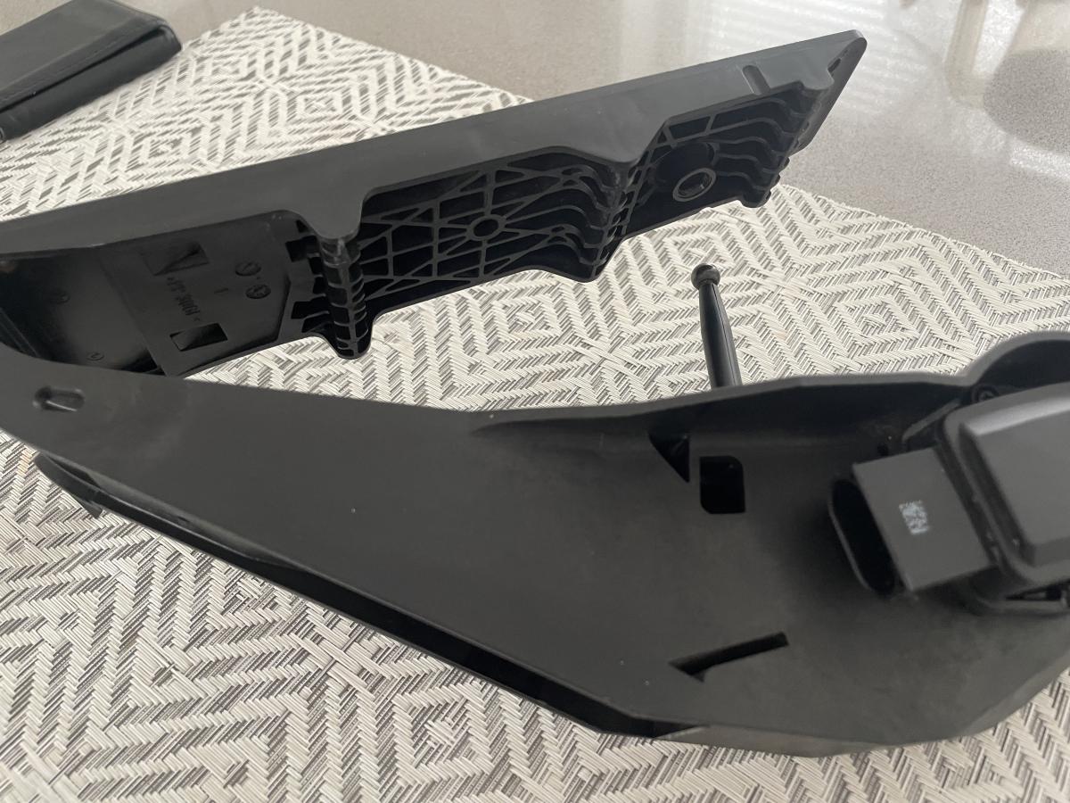

        the gas pedal I was hoping you can just transfer the pedal. See the photos below.
        the plate snaps to a ball joint, and the base of the hinge just slides off. The assembly shown is my Z4M OE pedal, but I think is interchangeable with E46 chassis!??? As long as the ball socket is in the same area it can be swapped with a Gx pedal.

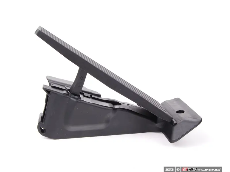

          G8x pedal is different. For you it'll still be plug and play because the actual mount to the chassis is the same.
          On the E46 it's different since the chassis mount is different and the newest style pedal doesn't have the balljoint in the same place
          Click image for larger version  Name:	image.png Views:	0 Size:	148.1 KB ID:	354167
          (this is the newest version of the standard pedal rather than the M one, but the mounting is the same)​
          The brake/clutch pedal might go reasonably okay with the prior gen stainless gas pedal (which is still available)
          Click image for larger version  Name:	image.png Views:	0 Size:	843.8 KB ID:	354169
          I don't think it'd be impossible to 3d print a bracket such that a new style pedal can be mounted to the old style chassis, but I'd need to experiment to see​

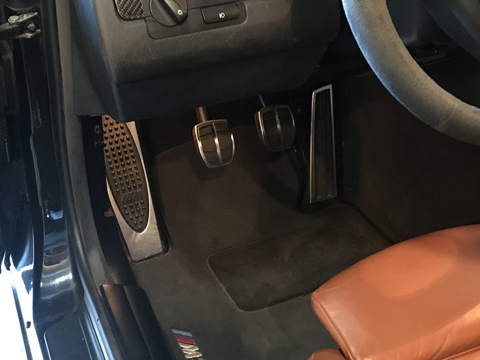

              Thanks for posting the pics maupineda
              My issue Now is that if i want to left foot brake which i need to sometimes it hits my right foot due to the shoes.
              I am going to have to go back to the GP pedals setup unless I stop Left foot braking LOL. Remember my car is an SMG
