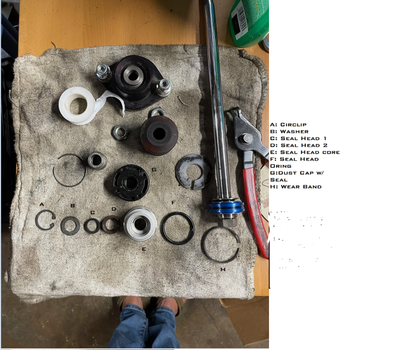

                  Just wanted to see if I could repair it, just to do it.
                  Got it apart, thanks to some wisdom from Pavlo
                  You actually have to have gas in it to loosen the dust cap. I initially degassed and was stuck. The dust cap threads onto the shiny aluminum piece, and without the gas pressure they rotate together. All the sealing is done by the seal head, and it's all held in with a circlip.
                  Working through sourcing the seals at this moment. It looks like it uses a custom two piece seal for low drag, for the main shaft seal. Looks like that was a selling point for the 4150 way back. I should be able to get away with a regular u cup seal? At work right now need to grab some more measurements when I get home.
                  Some info: I found on the seal
                  Worst case, I am just where I started but figured I'd share if anyone wanted to see what the inside of it looked like.

                      A Bit About How the Shock Works
                      Untitled by Kurvenkamph Motorsport, on Flickr
                      Part E is the shaft guide and main seal head. It originally sealed via Parts C and D, a special two-piece seal you can find in Vorshlag’s documentation. That seal’s no longer available, so I said screw it and went with a standard U-cup.
                      Now Parts C and D are replaced with the single-piece seal, which handles all the hydraulic sealing. It’s held in by Parts B and A—a washer and a circlip.
                      Part E also seals against the shock body with an O-ring, which holds both oil and nitrogen in. But this O-ring is a weird, obscure size—probably would’ve taken weeks to get from Europe. That would've killed my motivation, so I reused it.
                      The piston (anodized blue) also has an O-ring. It supports Part H, the wear band—a sort of hydraulic piston ring. VANOS fans will get it.

                      Why the Shock Had to Come Apart
                      The shock was leaking oil and gas pretty bad on the car—but it was still holding pressure, about 50–60 psi when I took it apart.
                      So I just ordered the shaft seal. It was the most likely failure point, and I could get it fast enough that I wouldn’t lose steam or get distracted by another project.
                      I wasn’t even sure I could reassemble it. And I made a dumb mistake: I pulled the dividing piston without measuring it. Don’t do that. You’ll be sad.
                      Another unknown: how much oil it takes. I saved what came out, but since it had been leaking, I couldn’t rely on that to get the fill right.
                      I ended up using 3wt racing shock oil from Amazon. The original was probably a Motul—red and lower weight—but close enough for now.
                      Got it all assembled... then the nitrogen tank ran out. Luckily found a shop open Saturday that could fill it.
                      I matched gas force by feel, using the other (good) shock as reference—about 55 lbs of force. Both shocks rebounded at full soft in the same amount of time. Compression and rebound were smooth, no dead spots.
                      Reinstalled it, and have put 200 miles on it—still bone dry. I check by wiping the shaft with a clean paper towel. So far, so good.
