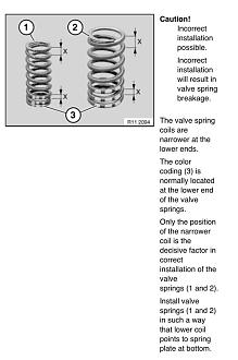

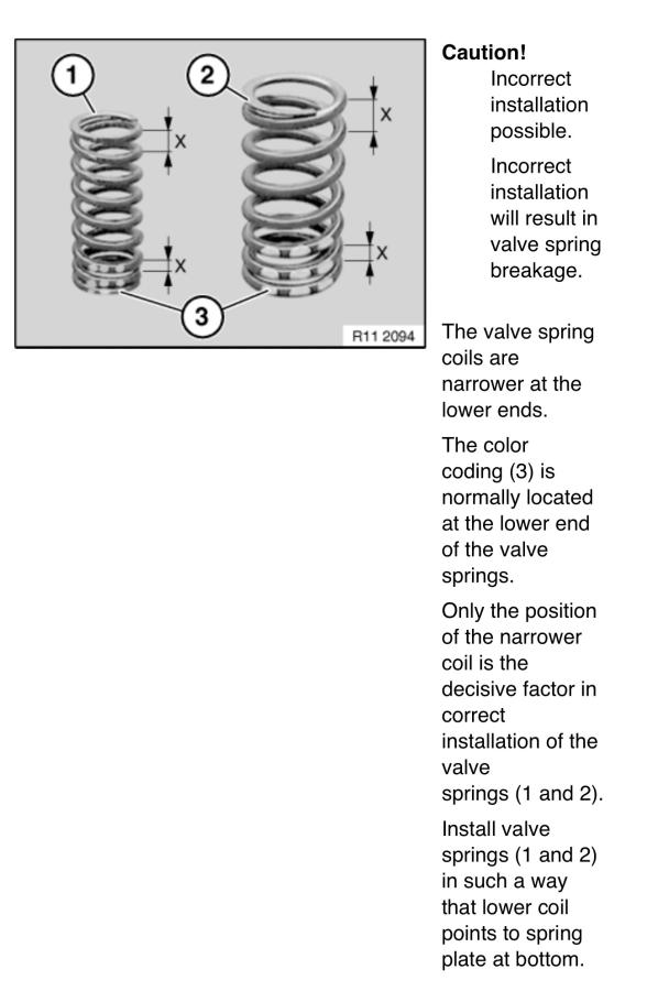

                Valve springs upside down.

                    I have seen this too many times now lol, even if the paint is gone you can see it by the coil, but people just don't care.

                        Wait, WHAT?
                        A shop put that on... is this what caused the wear???
                        These springs normally have the smaller opening at the paint code end, but they should be inspected -- not just rely on the paint -- and assembled with the larger opening end to valve keeper. Incorrect assembled can cause spring being compressed more, causing higher load on the cam lobe, leading faster wear on rocker and lobe.

                          so I just went to the shop and he's saying you uses a press and it doesnt matter if the spring is upside down. This doesn't change the spring rate and the cam load is the same.
                          I didn't argue with him as I told him Im going to bring him the head.
                          Looks like he's standing firm on "I'm not the cause of this".
                          I gotta build a case for when I bring it back on Monday. So now I'm writing to you guys (my legal team), for a rock solid argument.

                            For reference

                              For reference

                              Hes saying he can fix the cam lobe, is this possible? Obviously he's trying to get out of paying me for a new one.
