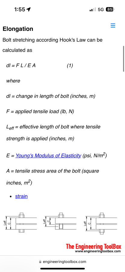

                        dl = FL/EA
                        F = E * A * (dl/2) / L (dl is halved because of assumption 1)

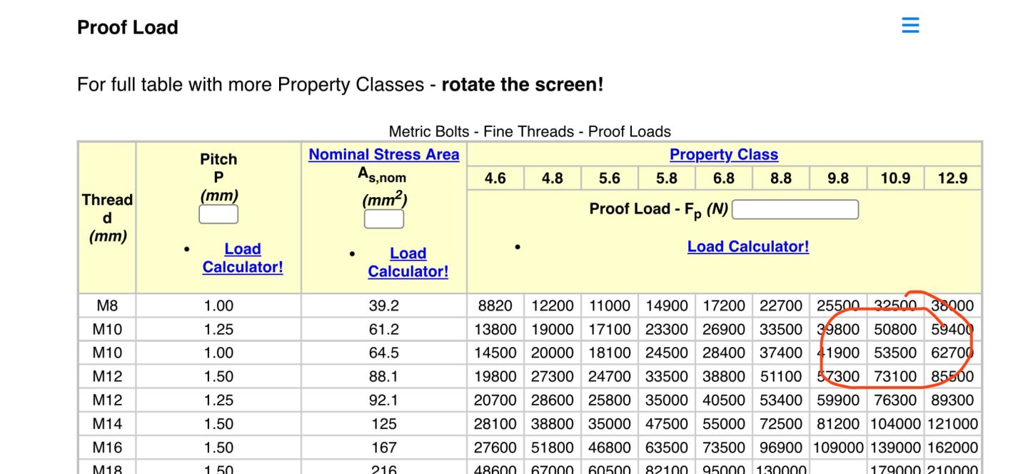

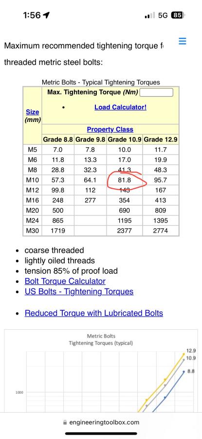

                        Proof load (pure elastic) of an M10 10.9 fastener is ~ 53500 N @ 82 ft-lb
                        Tension at 44 ft-lb therefore ~ 29000 N (due to assumption 6)
                        Add Case 1 and tension (if we were still elastic, which we’re not) is above 95,000 N.

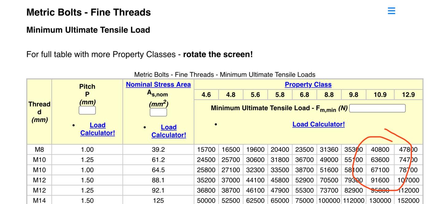

                        If our elastic region ends at a tensile load of 53,500 N, then anything above that is causing plastic deformation and permanent stretch. Ultimate tensile load of an M10 fastener is minimum specced to 67,100 N, so the rough math very much agrees that this fastener is going to be yielding, even if you barely torqued it before the 90 degree turn. If you torque it to yield over and over, IT WILL FAIL.
