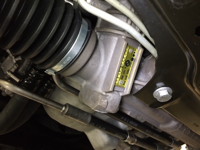

    I'm seriously thinking about the steering rack swap to a yellow tagged rack. I've always thought the steering on the M3 was to slow for the track. Anyone have tips and things to look out for?

    Look out for a good condition .712 and don’t look back.

        It's a great upgrade for the E46 M3 in my opinion and it provides very quick steering. The ratio is the same as the popular z3 rack at 13.7:1 but you get more lock with the 712/ZHP rack. One thing to note that may catch people off guard the first time they drive the car with this rack is that at the very limit of steering lock the 712/ZHP rack can "catch" making it feel like the rack is actually locking when you reach full steering lock. It usually only happens at slow speeds when going to the absolute limit of steering lock and is easy to avoid. If it happens you just provide a bit more force to unwind the wheel and steering goes back to normal. Awhile back BMW offered a "stroke limitation kit" to limit the lock and prevent it from reaching the point that this would happen but to me it's not an issue. Just wanted to point it out though in case you get this rack and encounter that.

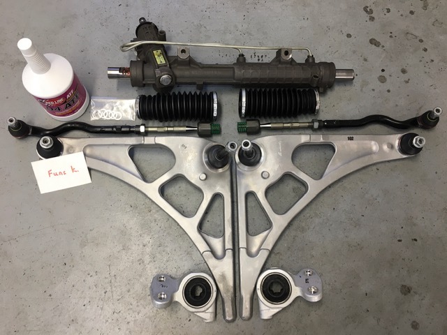

        I just installed a 712 rack among other front end components for a customer last week and he's very happy with the steering feel. His text to me when he got home was "there is literally no more play on the wheel, every ever so slight movement of the wheel makes the car do something, it's awesome"

            Ok, I just bought the rack(Yeah!). What else would you recommend I get? How much can I reuse off the old rack?
              What is the best place to get a 712 online. I dont need to get the right and left arms with ball joints as mine are brand new.
