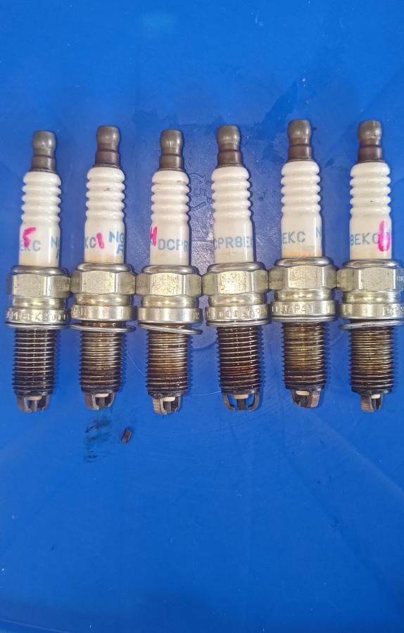

                    Whoa, i just pulled DCPR8EKC's from mine, not sure if they were installed by mistake by the previous owner or what
                    Even me pulling these for comp testing and repairs didn't notice the C Vs P on the end, my bad
                    So glad i swapped these out today, big relief to know the P are in
