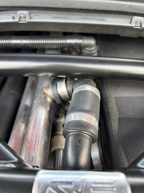

Just installed the brace and notice this after driving for a bit … it was quite hard to install. Have others seen this or is this bar defective? The breather tube plastic locking ring is broken, but no CELs so seems to be holding a seal for now. Going to track in a couple of weeks though.
Rogue engineering strut brace - anyone have interference with cam breather tube?
Rogue newer batch (RE plate logo) of strut brace get in contact. Previous design (sticker logo) had 1 bend and newer has 2. I had to make 1/4'' shims on top of strut towers to compensate on a friend's car.Send me a pm for Gt4 Composites carbon fiber CSL parts
I machined an aluminum disc 1/4'' thick to fit between strut towers and brace.Originally posted by Maxhouse97 View PostI have the 034 motorsports mounts.
Good to know there were two version; I’ll ask Rogue which one I have. With the shim did you just use washers or perhaps the strut tower reinforcement plate from BMW on the top instead of from underneath?Send me a pm for Gt4 Composites carbon fiber CSL parts
