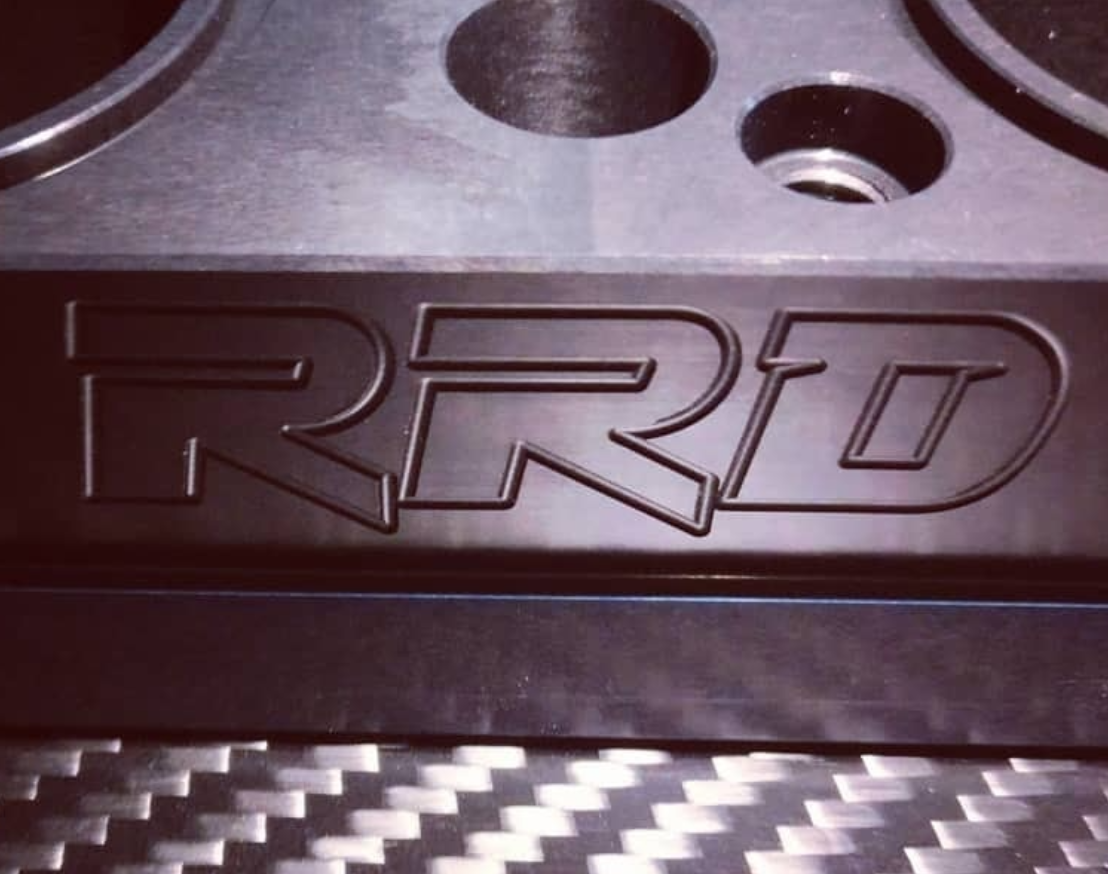

                  7,680 Followers, 7,582 Following, 557 Posts - See Instagram photos and videos from RRD - Rabid Racing Development (@rabidracingdevelopment)

                          Then there is this:
                          39 likes, 4 comments - autosportfab on August 7, 2023: "We have a #s52 powered car on the dyno today for a health check after some work we did over the winter. With some tiny tweaks we made to hardware we picked up power through the RPM range. Note: Our @dynojet224xlc allows us to warm up the driveline identically every time. We load the car until we get to 185 degrees of water temp and 185 degrees of oil temp and make our pulls. This #s52 has @epicmotorsport race cams, valvetrain and tuning and @autosportfab throttle body. This winter she may get ITBs!".
