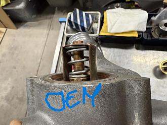

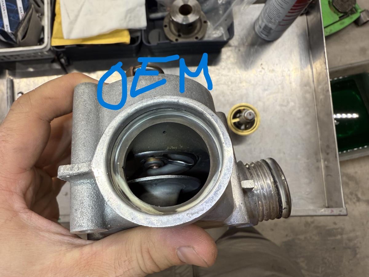

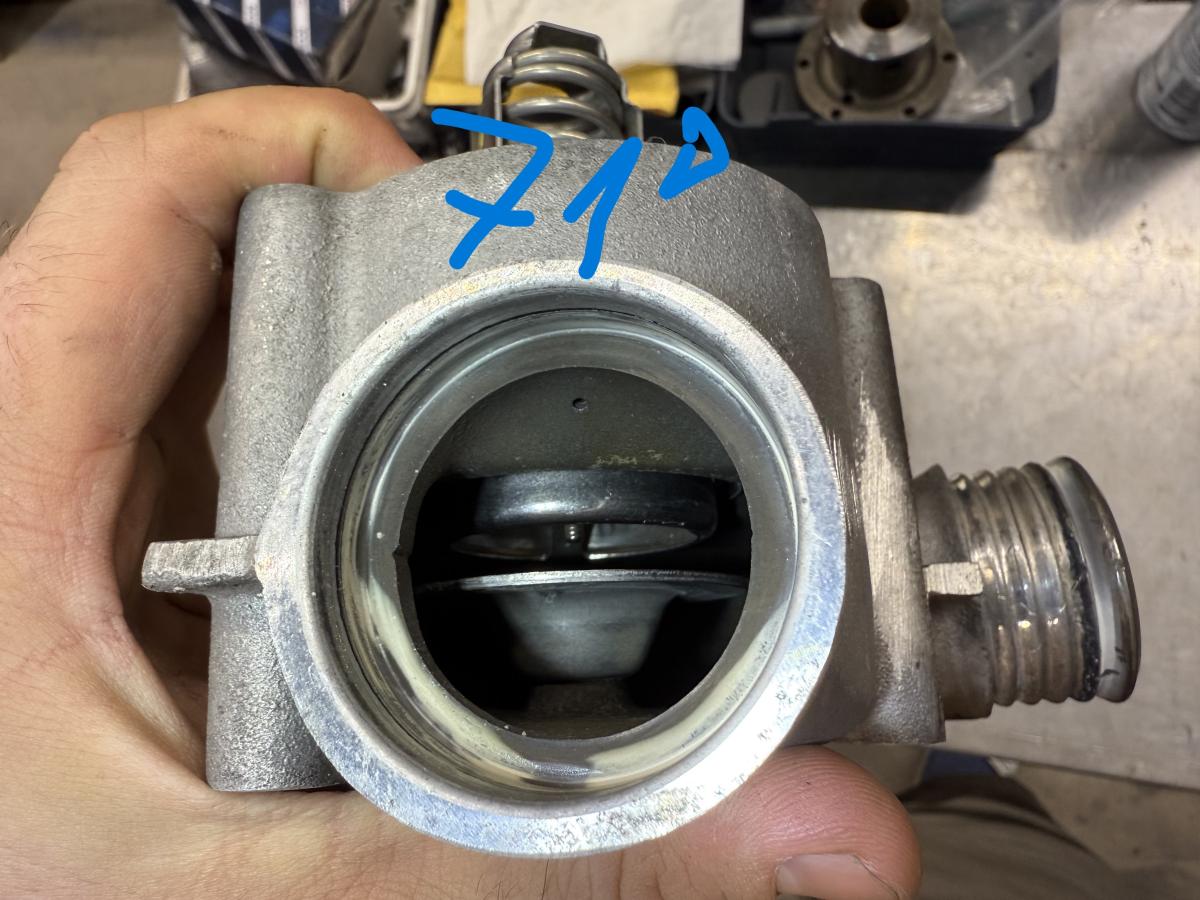

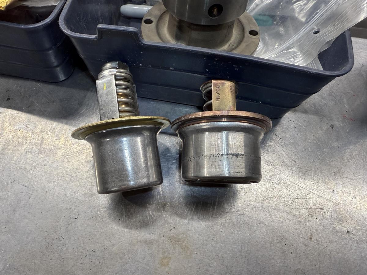

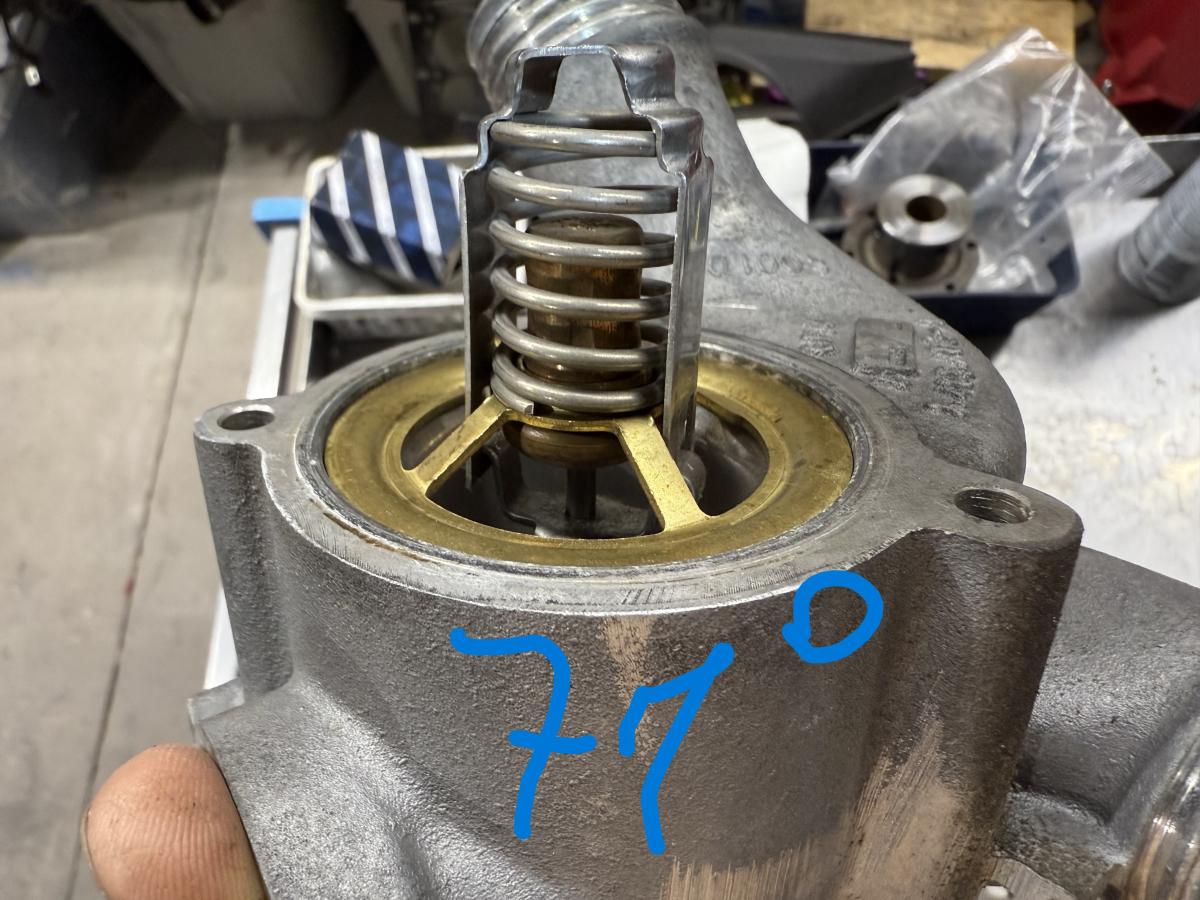

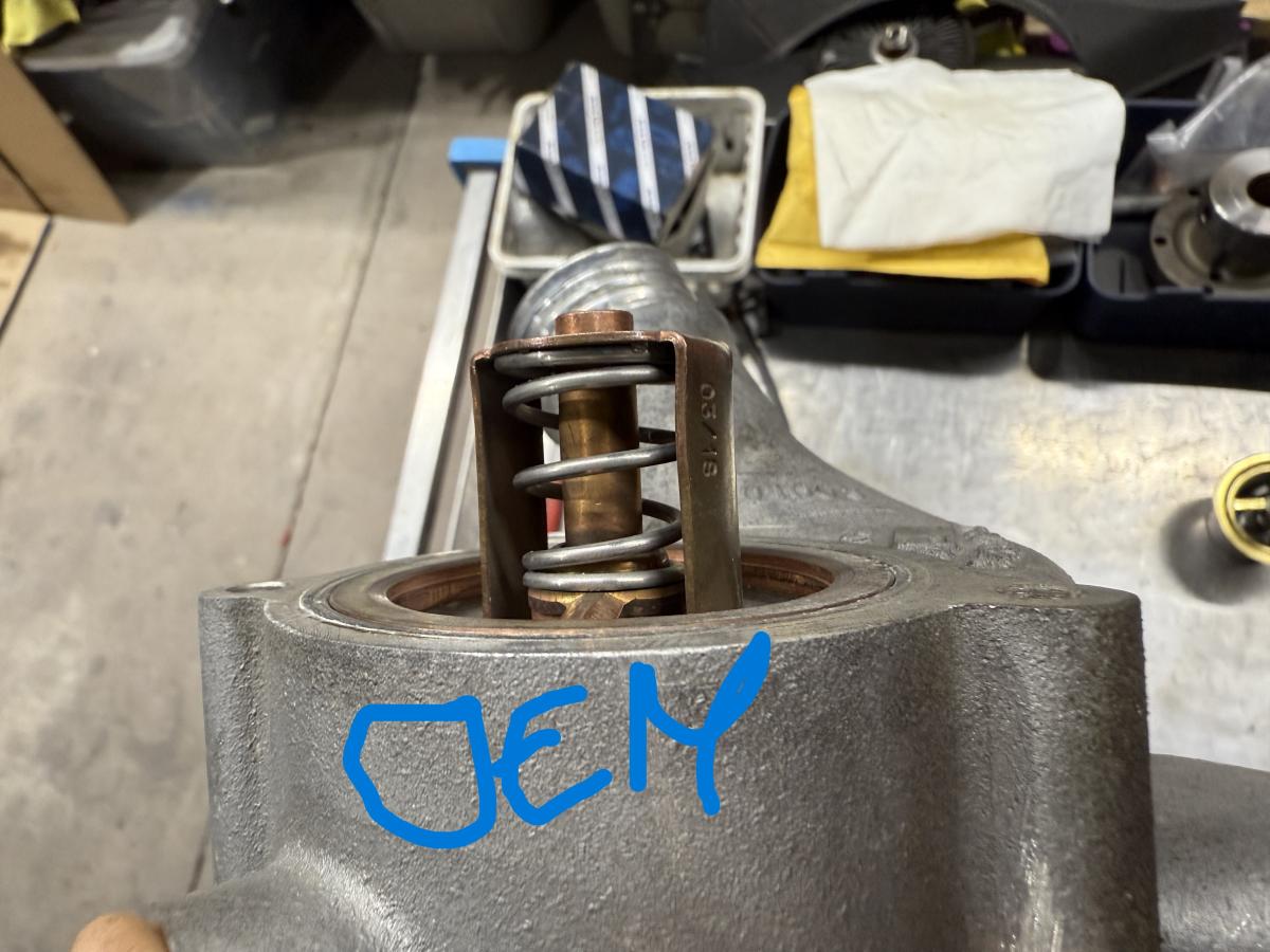

      What I noticed. The Motorad is longer than OEM, both the spring part and cup part. Diameter is correct but flange thickness is less than OEM so it doesn't sit flush with the housing. Also the cup sits deeper in the housing. Maybe somebody can elaborate if that's going to be a problem technically?
      See pictures attached. I labeled the Motorad as 71 degree in the pictures.

        The motorad unit will essentially act an always open thermostat. This will not work.

            Do you have a picture of the top of both thermostats? I know most aftermarket thermostats for our cars use a nut to hold the wax pellet to the spring. The OEM one looks like it’s riveted—maybe you could drill it out and reuse the lower temperature wax pellet with the OE spring and casing.

              The Motorad has a nut, the OEM S54 is riveted.
