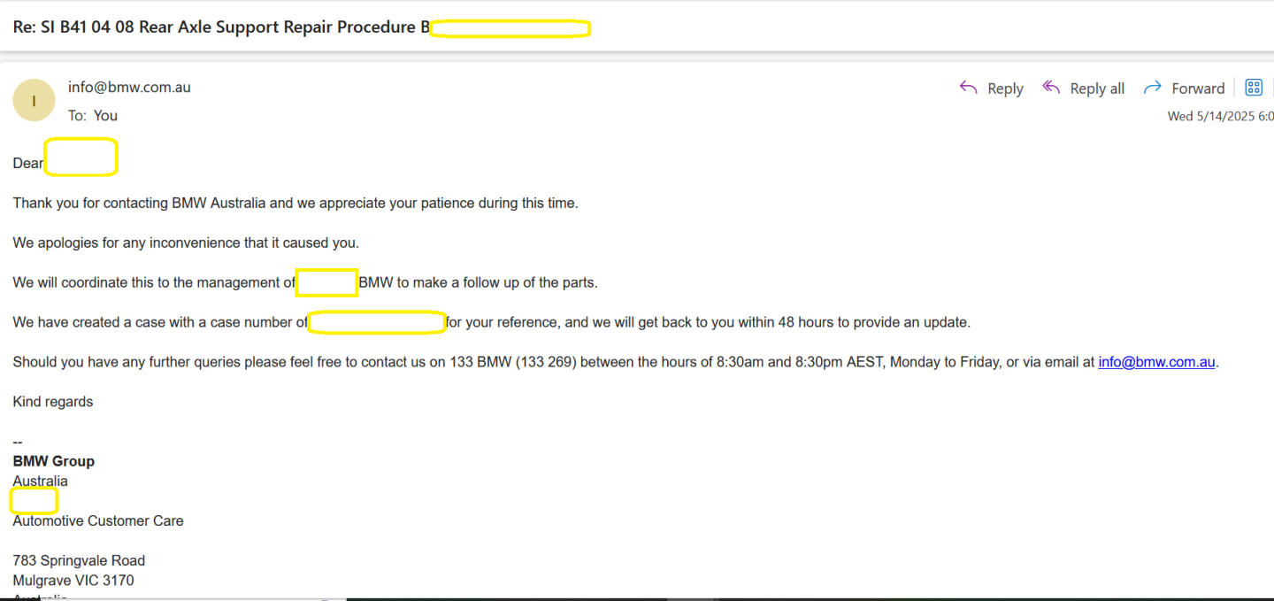

          This is the email response i got from BMW Australia
          Not sure what to make of it
          Your Thoughts

            I wonder if they are just doing the foam fill "repair"
              The Foam is discontinued….sine a couple of years already…….so likely no
              and yes the panel is indeed not available
