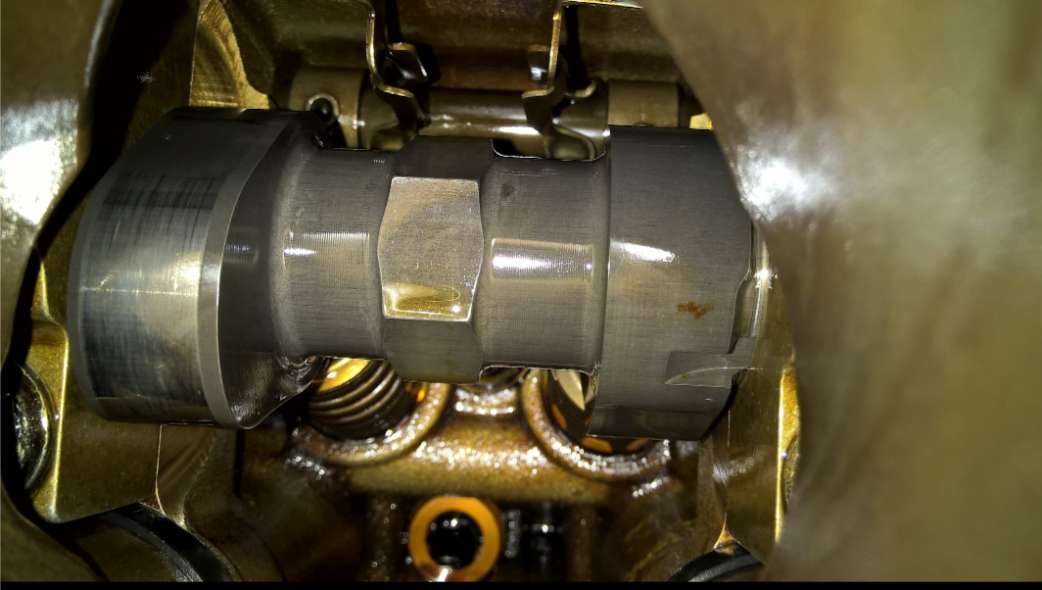

    ZiMMie unfortunately he's right. After my ordeal with the post COVID Schricks that failed after break in of about 1,200kms I got a full cat cams set. The intake cam where the vanos vvt socket goes, the one the cam sprockets bolt to, and where the spline shaft enters was of conical shape. Smaller at the mouth and larger at the rear. Off by 0.015 at the mouth and +0.025 at the rear. Dad's a veteran Peng, said that after the hardening process they didn't recheck the cylinder values since the coating inside the cam was consistent with the rest of the piece (ie no machining traces).
    Upon contacting catcams they said impossible until I showed them video and pics. They took care of shipping and returned the cam machined, I didn't get a new one as this cam was brand new never used.
    I've been running the cat cam setup now for 2000km+ and no issues so far. I've delayed the new injectors and fuel rail to take my time with break in.
    Once you open up the engine and deviating from stock you take major risks, financial and emotional.
    This is why I removed my head, got it machined, new hardware and went with Schrick. I saw these issues arising so I ended up spending $7k on the head. I prefer everything right. All hardware, including sensors, is also getting replaced. Some are going to see this and understand, others are going to have a brain aneurysm.

    Just FYI the notion that you don't need followers is now pretty much false. Both Schrick and Cat Cam will not warranty cam damage if you don't buy their full cam kit with followers (and oil bridge, drilled rocker arms for cat cams). I say this because I've been through this with Schrick based on this historical "data" with many members here.
    Since COVID the metallurgy for the cam manufacturing process has changed. Followers should be included in this purchase price. If you love the S54 a cammed CSLed one is pretty much top of the food chain type shit.
