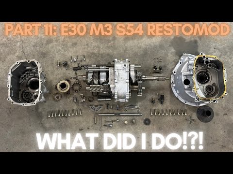

    Came into my feed. Not much info out there on the 420g so figured I would drop this video here. The youtuber tried to swap bellhousings from a 540i v8 but the input shaft length was different. Pretty decent teardown info on the 420g.
    Nice find! Someday I will do a similar operation on my old ZF320. Just need to swap the guts.
        Uh...I think it was already known that a V8 420g is not compatible with an I6. But the video is still interesting and something different. Worth watching.

              He didn't tell/show the secrete steps how to remove the rear housing off, which is quite involved.

                It unfortunate that that we can't just swap the bellhousing on the V8 units. I guess transmissions can have the same p/n and be different unless there is something I am missing.
