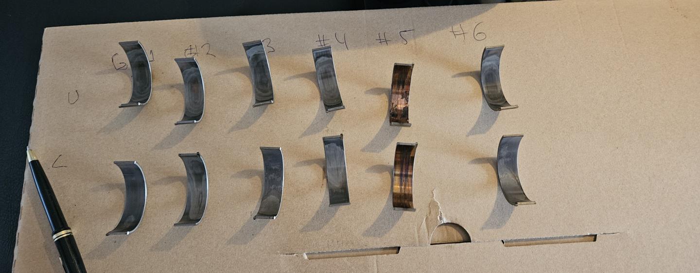

Two of these are not like the others - #5 Rod Bearings Spun
    Click image for larger version  Name:	20250531_192840.jpg Views:	191 Size:	106.9 KB ID:	306947
    cylinder 5 bearings did not come off with the caps they were somewhat stuck on the crank. Car had some start up rattle for a few weeks. On Thursday May 29th I noticed what I thought was rod knock. Since I had already purchased all the parts to do my Rod Bearings I started the Job this morning. The good news is somehow the crank is fine.
    Car has 135000km / 83000 miles.

        The #5 rod bearings definitely spun at some point. I was so relieved to have "caught" the damaged bearing that I focused on the crank journal and the bearings' condition, overlooking the back side. Last Saturday, after changing the oil and sending a sample to Finning Canada for analysis, I watched an old RoadKill episode showing the back of a spun rod bearing from one of their project cars. My heart sank instantly—I couldn’t recall checking the back of my bearings.
        Living in a condo, I do all my wrenching at my in-laws' garage, where I’d left the bearings. I rushed to inspect them, and sure enough, I confirmed what I saw: undeniable signs of spinning.
        Click image for larger version  Name:	Bearing.jpg Views:	0 Size:	66.9 KB ID:	309399
        The bearings have spun, but I'm cautiously optimistic that I might have dodged an even bigger bullet than I realized. Granted this might all be just wishful thinking, but here's my reasoning.
        The car has clocked over 2,000 km with these new bearings, and I haven't detected any rod knock.
        My theory (and hopeful speculation) is that the bearings spun inside the rod, not around the crank journal, perhaps only a few times before stopping.
        Why do I believe this? The wear on the unoiled backside of the bearings is minimal, despite the intense forces at play, and when I removed the rod cap, the bearings remained on the crank journal, still perfectly aligned as if secured by the rod, with the locating tabs mostly intact.
        For now I am waiting to see what the oil analysis comes back with and being 100% realistic it is very unlikely I got away with just replacing the bearings on #5 and the knock will be back, but I can dream.
        Wish me luck.
