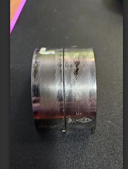

    cylinder 5 bearings did not come off with the caps they were somewhat stuck on the crank. Car had some start up rattle for a few weeks. On Thursday May 29th I noticed what I thought was rod knock. Since I had already purchased all the parts to do my Rod Bearings I started the Job this morning. The good news is somehow the crank is fine.
    Car has 135000km / 83000 miles.

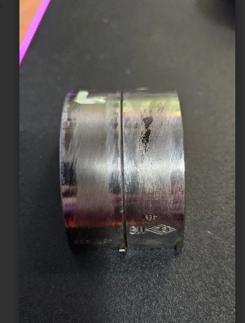

        The #5 rod bearings definitely spun at some point. I was so relieved to have "caught" the damaged bearing that I focused on the crank journal and the bearings' condition, overlooking the back side. Last Saturday, after changing the oil and sending a sample to Finning Canada for analysis, I watched an old RoadKill episode showing the back of a spun rod bearing from one of their project cars. My heart sank instantly—I couldn’t recall checking the back of my bearings.
        Living in a condo, I do all my wrenching at my in-laws' garage, where I’d left the bearings. I rushed to inspect them, and sure enough, I confirmed what I saw: undeniable signs of spinning.
        Click image for larger version  Name:	Bearing.jpg Views:	0 Size:	66.9 KB ID:	309399
        The bearings have spun, but I'm cautiously optimistic that I might have dodged an even bigger bullet than I realized. Granted this might all be just wishful thinking, but here's my reasoning.
        The car has clocked over 2,000 km with these new bearings, and I haven't detected any rod knock.
        My theory (and hopeful speculation) is that the bearings spun inside the rod, not around the crank journal, perhaps only a few times before stopping.
        Why do I believe this? The wear on the unoiled backside of the bearings is minimal, despite the intense forces at play, and when I removed the rod cap, the bearings remained on the crank journal, still perfectly aligned as if secured by the rod, with the locating tabs mostly intact.
        For now I am waiting to see what the oil analysis comes back with and being 100% realistic it is very unlikely I got away with just replacing the bearings on #5 and the knock will be back, but I can dream.
        Wish me luck.

          I think both crank journal and rod are damaged. Pictures of the crank journal and rod in good close focus?
            No free lunches IMO, it spun and will fail again. I remember doing the same on an R32 a couple decades ago, I got roughly another 25k on that engine before it failed gloriously
              Thank you, that's really encouraging! 😊
              Regrettably, I didn't capture photos of the crank journal or rod during disassembly. I wish I had, though, as you know, photos aren't great for evaluating surface finish.
              I'm roughly 85% certain the crank journal is fine (I was completely sure when I put it back together). I closely examined it while cleaning the oilers, and it appeared flawless. Maybe it ovalled, but my plastigage measurements showed a steady 0.050mm clearance across all cylinders.
              In the late '80s, I assisted a friend with replacing rod bearings on his 5.0L Mustang. Stranded in a remote area without a machine shop, we chanced using a slightly scored journal. That bearing failed again after only 50 miles—definitely not a fun experience.
              This engine might be a ticking time bomb, but I’m hoping for some luck. If the oil analysis looks bad, I’ll likely pull the engine for a winter rebuild project.

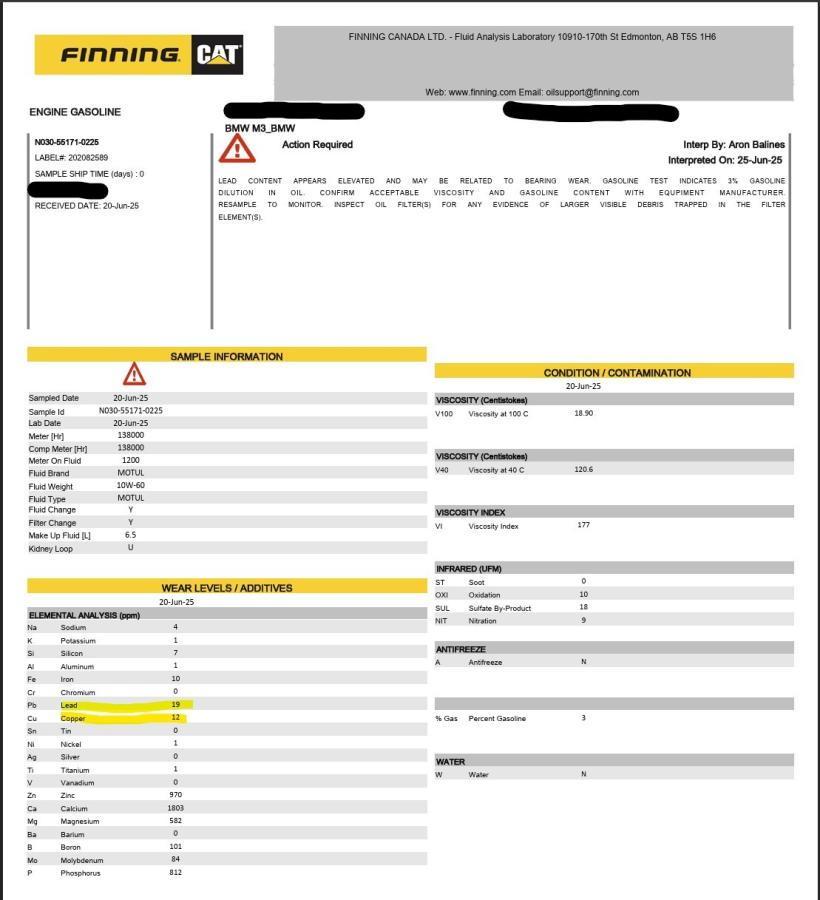

                    I received the oil analysis from Finning, and it shows elevated Lead and Copper in this 1600km sample. I’m not overly concerned just yet, as the new bearings now have over 3200km with no knocking during cold starts. The elevated levels could be residual from the previous bearing failure, or possibly the new bearings settling in (though that seems unlikely since they shouldn’t be making contact, despite what some online sources claim). Alternatively, it might indicate a bigger issue, so I’ll keep monitoring. Stay tuned.

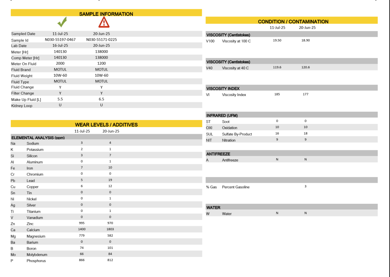

                              Looks like things are moving in the right direction, still no cold start knock and just got the second oil Analysis back and while Lead / Copper are still showing up in trace amounts they are trending down.
                              Car now has done roughly 4000KM since the bearings were replaced.
                              If I can get another 3000 KM before I put her to sleep for the winter I will do another Oil Analysis, then I am going to want to do oil changes every 5000KM which is my normal interval and normally my annual amount of milage.
