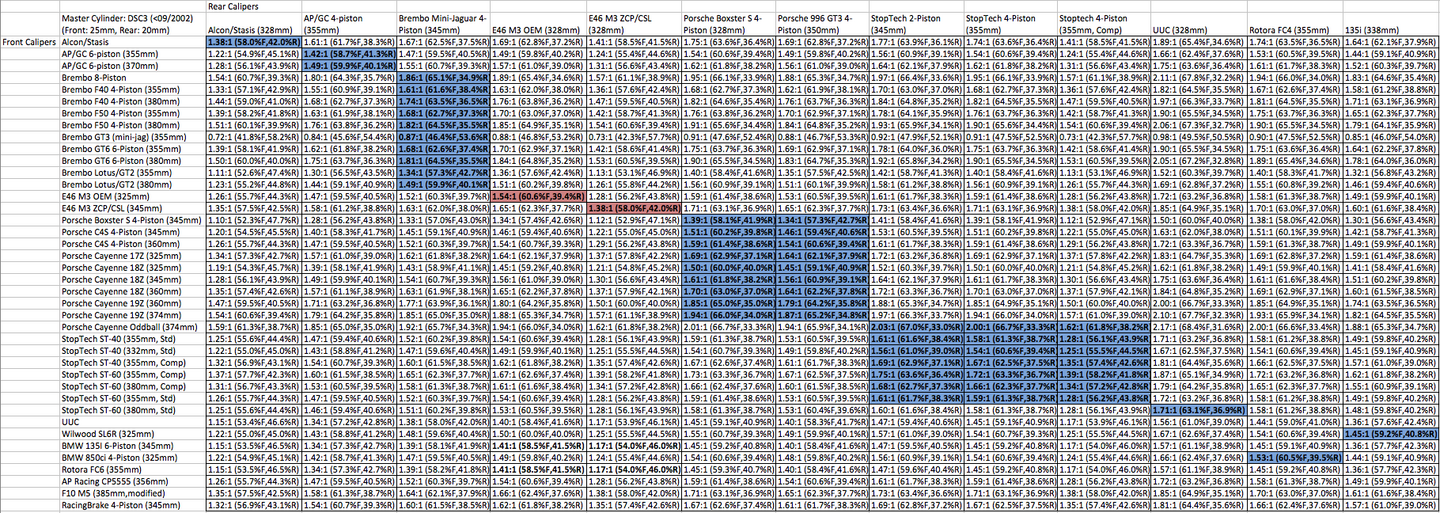

    Would anybody have the capability to recover this post. Or the source data (bias by caliper/disk) Was really useful.

      Here are the charts that I saved from the brake bias thread from the old forum. The two charts are based on the type of master cylinder you have. First is the DSC3 (<09/2002) and the second is MK60 (>09/2002) even though the chart says DSC3, it's a typo from the original document.
Name:	E46 M3 DSC3 Bias Calcs v0.144.png
ID:	4954 Click image for larger version
Name:	E46 M3 MK60 Bias Calcs v0.144.png
