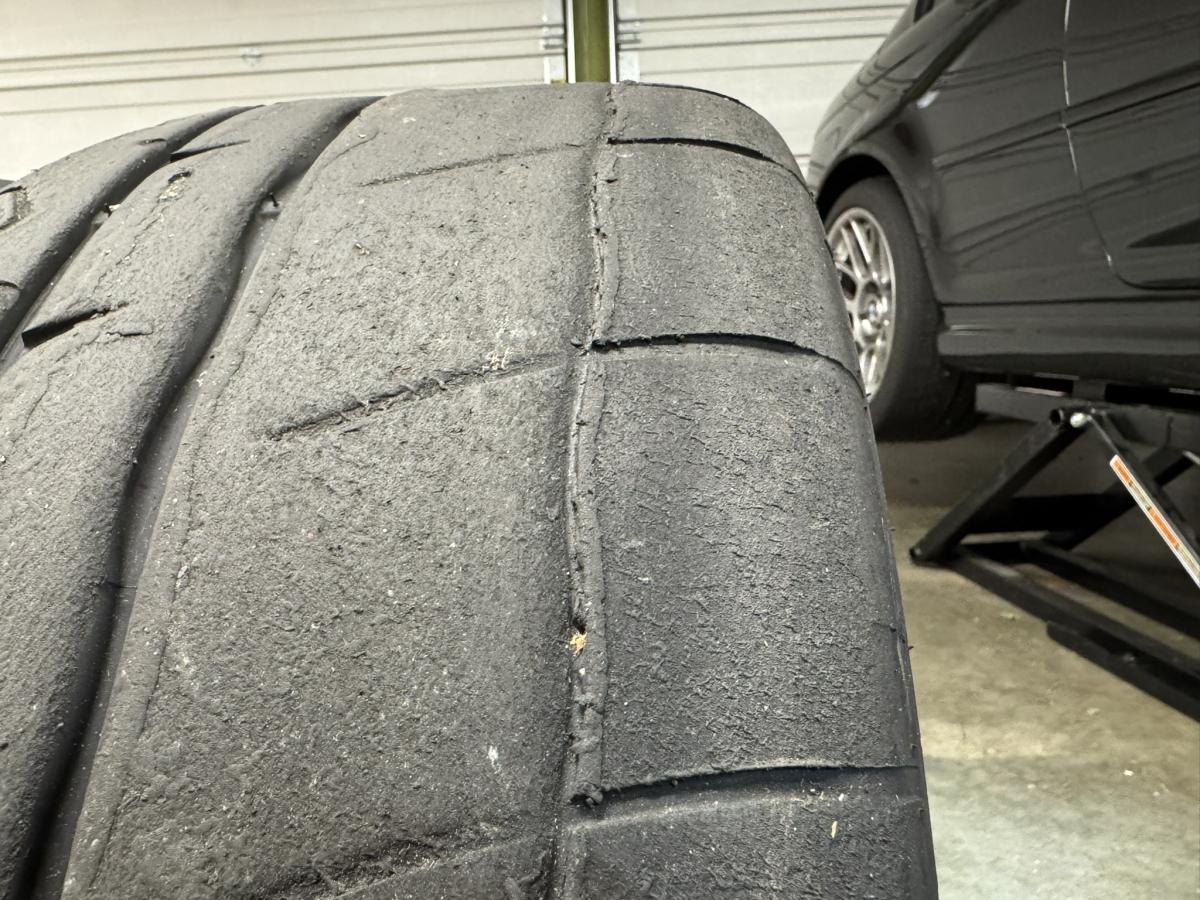

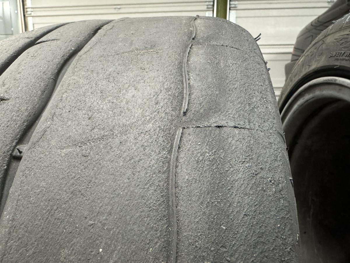

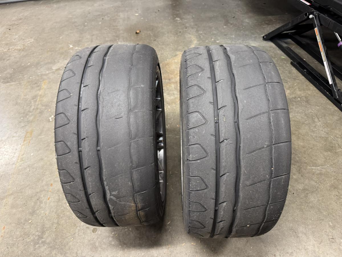

    Comparison of front tires after 1 day:​​
    Click image for larger version  Name:	IMG_4260.jpg Views:	0 Size:	154.6 KB ID:	307808
    Front left:
    Click image for larger version  Name:	IMG_4262.jpg Views:	0 Size:	201.8 KB ID:	307809
    Front right:
    Click image for larger version  Name:	IMG_4261.jpg Views:	0 Size:	209.3 KB ID:	307810

        Yeah that's the weird part. Using a probe-type pyrometer fresh off the track:
        Outside Middle Inside
        Front Left 52 59 67
        Front Right 69 70 70
        Rear Right 61 71 72
        Rear Left 56 65 71
        Which should mean front-right is wearing evenly, but obviously that's not the case.

        I do my own alignments, which would be suspect, but I feel like camber is the one measurement that's pretty hard to mess up.
        The Ridge is a CCW track and is pretty hard on front-right tires, but this still seems excessive.

                For the RF tire, my WAG is the camber is heating the inside portion, and your understeer/overdriving is heating the outer portion. You can see this by comparing the LF and RF heating pattern.
                  I have found that the V730 (and other cheaper tires) don't wear as nicely as other higher end tires I have run, I suspect it's due to inferior carcass/construction. However, I haven't seen wear nearly this bad or asymmetric with this tire. My first guess is something mechanically is off with that corner, likely a bad wheel bearing, bent/worn suspension component, etc, where you're losing a lot of camber under load. I'd also suggest running a wider wheel, but the V730 does run a bit narrow so you can probably get away with it.
                  Also, regarding tire temps, this seems to confirm it, typically you want to aim for the inside to be slightly hotter especially on tracks with lots of straights - I've never run Ridge, it appears more dynamic, but still, with almost perfectly even tire temps on that corner this usually suggests you're loading the outside of the tire too much on cornering, as only the inside is heated during accel/braking as well as from radiant heat, especially if you're pulling into the hot pit and checking with a probe. If you're running CCW, your RR tire temp spread looks just about perfect.
                  I'd also suggest zero front toe or slight out, and possibly less rear toe-in, depending on driving style and preference. These cars are quite stable when set up properly.

                      Way too much toe. 0 toe in the front, .15 total toe in the rear...or maybe a little less.
                      The problem is as you add negative camber, you have to reduce the toe. You're concentrating more heat on a smaller section of the tire which overheats the tire and causes excessive wear.
                      My camber is -4.25 front and -3.25 rear and I run almost zero toe front and rear. 1mm toe in each side on a 17" wheel which is about 7' or 8' which is a little less than half of what the OEM specs are.
                      Some of the uneven wear between the left and right tire will be caused by the direction of the track. Swap tires left to right...two floor jacks makes life easier.

                            Based on just the difference in wear, i'll mirror what others said and say that there is something mechanically going on with that corner. Bushings bad, wheel bearing, anything that could cause a change in camber, and fairly significant at that. At -4 degrees and 35 psi hot, there should be no rolling over of the sidewalls.
                            A lot of us are running V730s in GLTC and they are extremely reliable and consistent, so i'm very surprised to hear people struggling with them longevity wise.

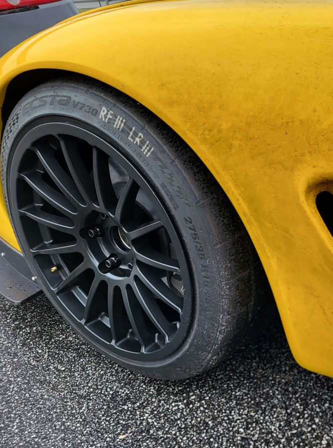

                            We ran 275s at 30-32psi hot (track dependent) on a 3440lbs car, square. Mild to no aero.
                            Click image for larger version  Name:	image_2025-06-13_224324574.png Views:	0 Size:	1,022.4 KB ID:	308529
                            One thing that we found helps with sidewall stiffness, is a light stretch. What size wheel are you running? For reference, 275 on a 11" is what we ran. Regardless though, i maintain that there is a mechanical issue there causing this uneven wear.

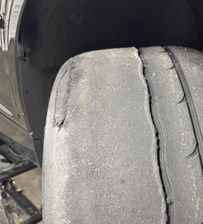

                              I was running 33 psi hot on a 3000lb car. All 4 tires showed similar wear. mine had been heat treated by tire rack.
                              One thing that may have contributed to my quick wear... I typically see ~8-10 psi increase over a 20 minute session. I allow 1 warm up laps, then start pushing. Its possible additional warm up time would improve tire life
