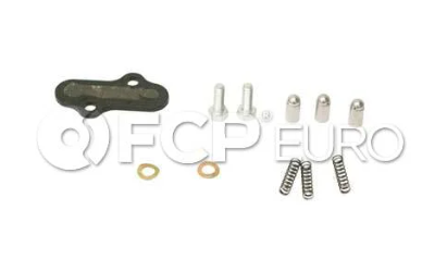

    I'm refreshing my transmission and planning on doing to replacement kit: 23317506947 and can't find the toque spec for the 2 bolts. Does anyone know what they are? Thanks!

    Just turn bolts to snug/bottom, then add 1/16 turns or 45*/2 more.

        Bmw does a tourque spec depending on the thread size at the beginning of the repair manual. It’s pretty much the same as the ones you’ll find in the internet just google tourque by thread size and you’ll find the table. Then all you have to do is measure the thread and voila…your fine
          I checked BMW's bolt based torque spec and it should be 88 Lb-in. Thanks everyone!

            These are 10mm bolts so the spec should be the same as the vanos bolts and 88 lb-in = 7.3 ft lbs sounds right.
