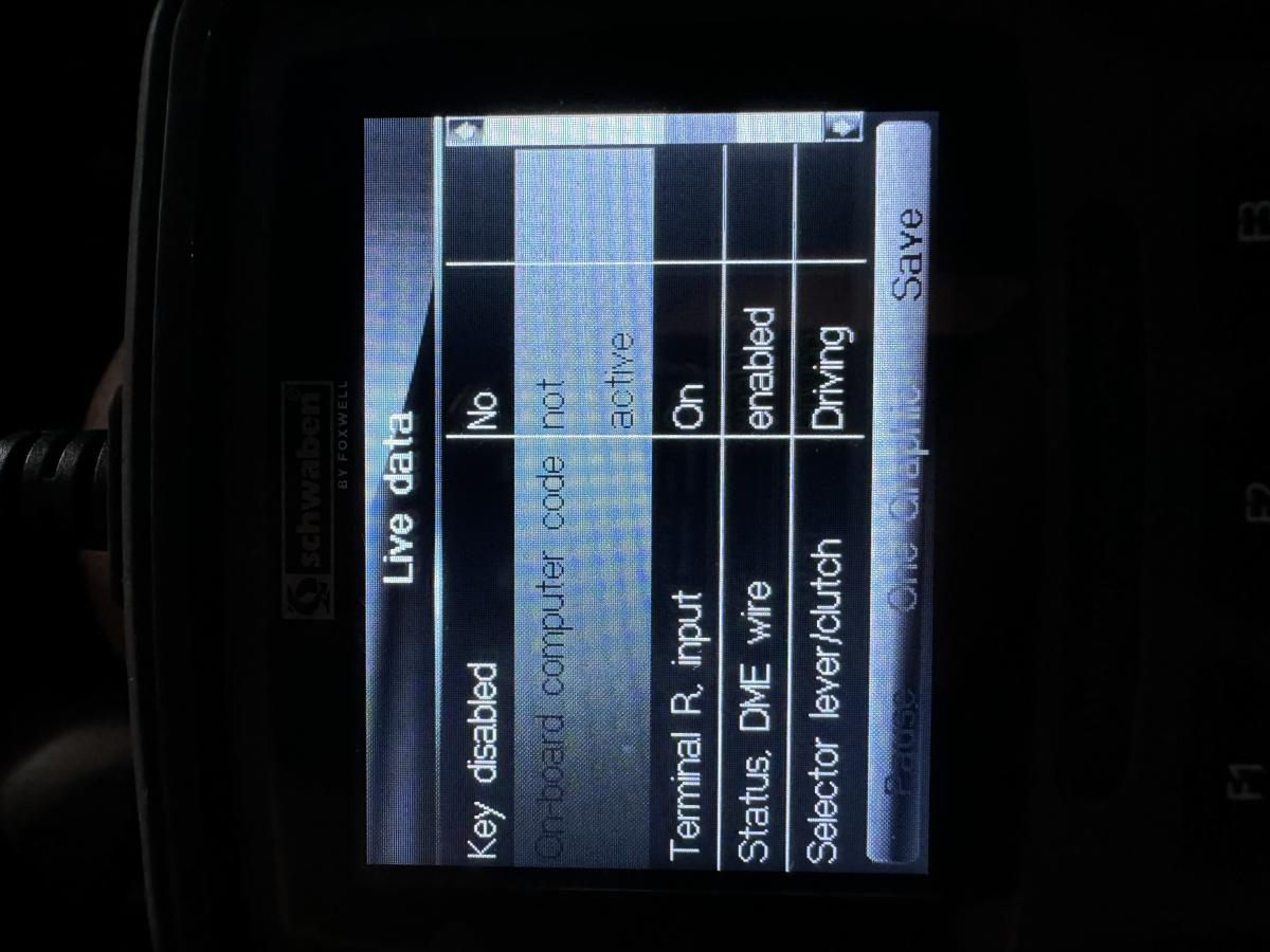

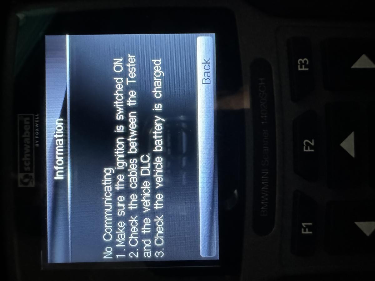

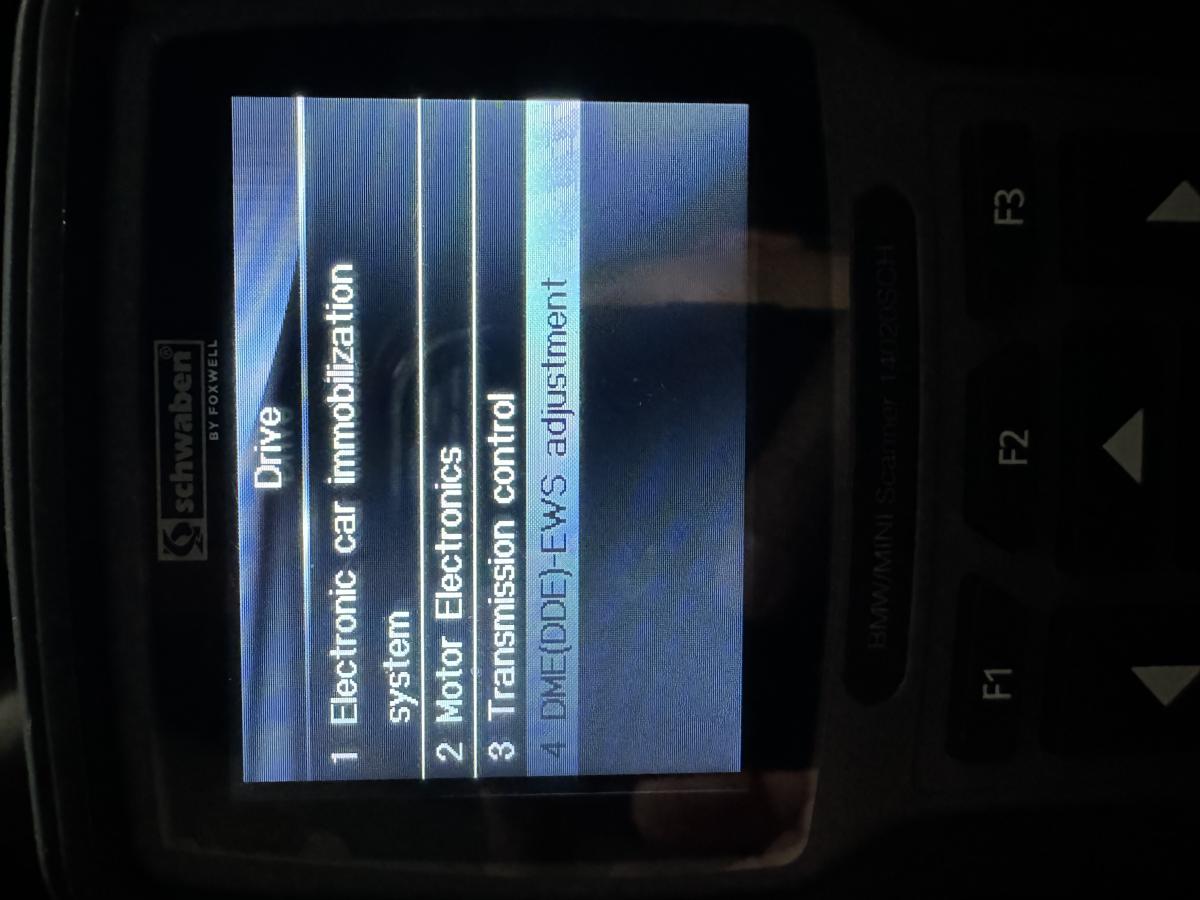

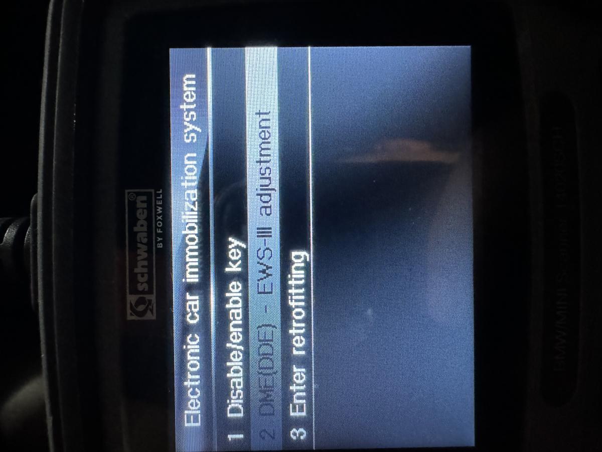

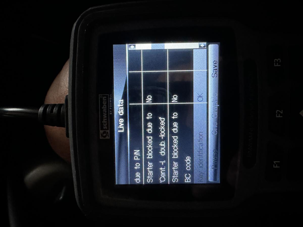

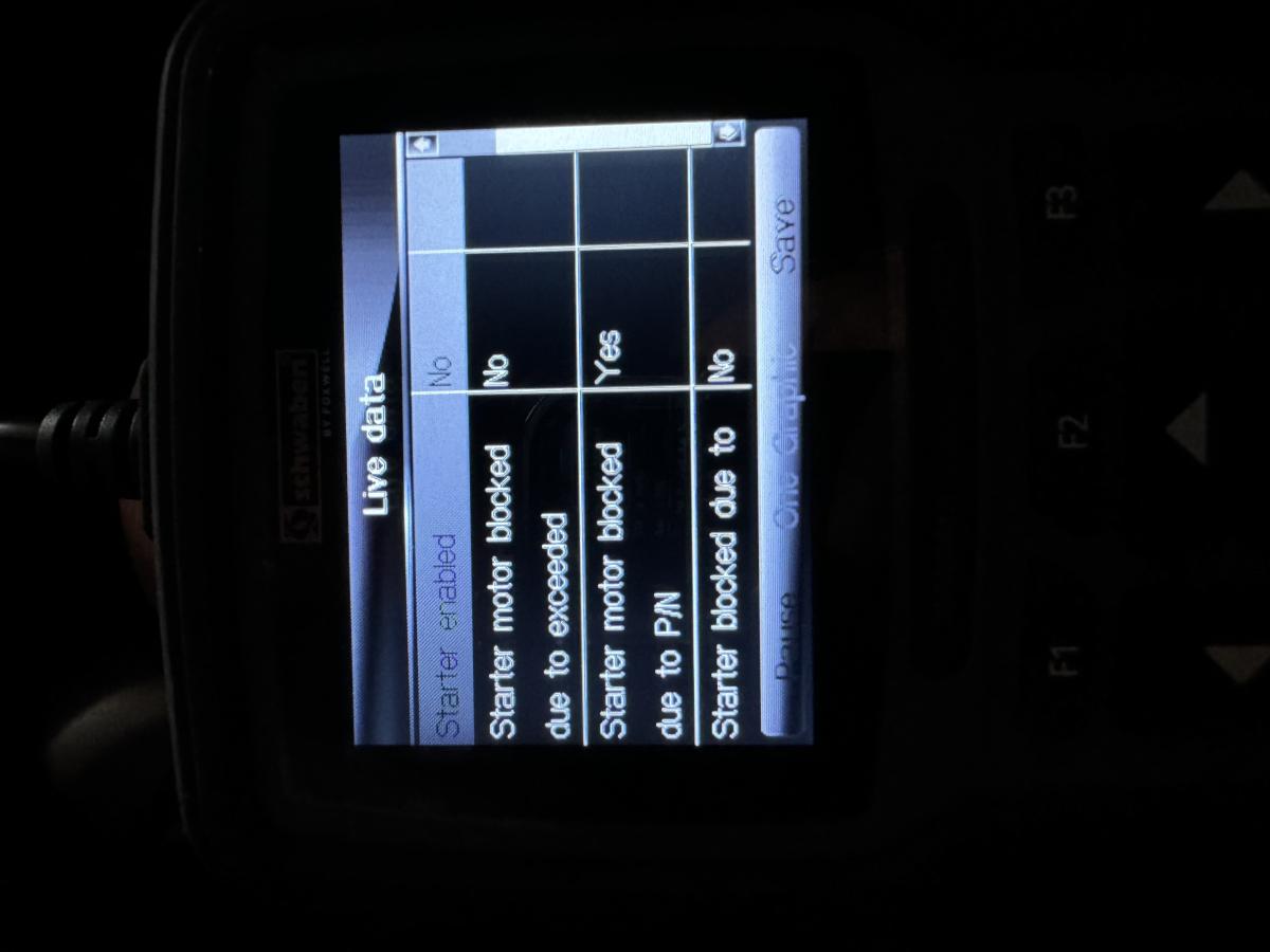

          Yes the engine was off, could not start it. I used a Schwaben scanner and did find starter enabled = no, tried to sync using the DME(DDE)-EWS menu function without luck. Error message could not communicate, I assume the scanner does not have the functionality.
            Error code

                Can anyone confirm INPA can sync the DDE/DME-EWS with a function and not have to edit/write directly to the boot sectors?
                  Yes. I used INPA to sync mine. If I remember correctly an error message appears, but you just click ok or whatever and continue on. It worked.

                      I didn't see any error codes just live data.

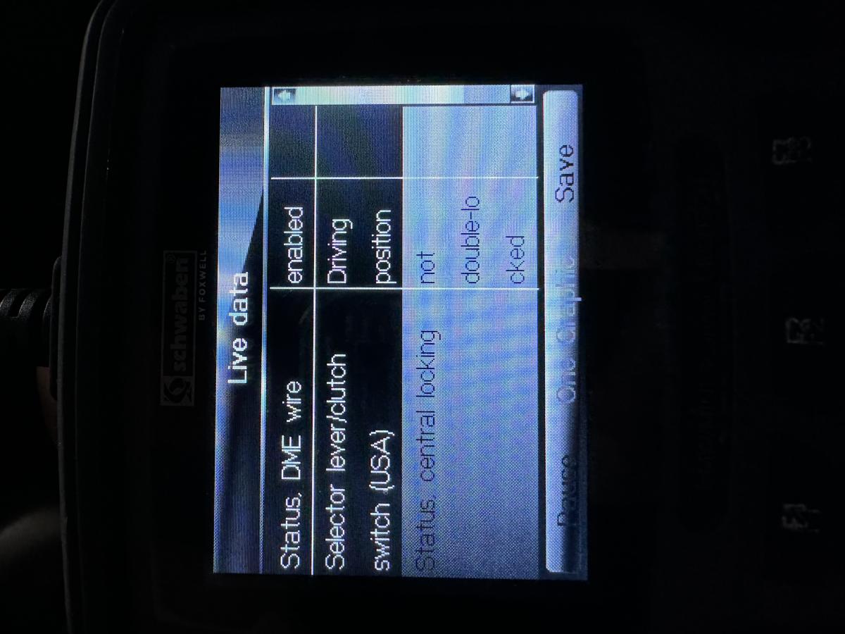

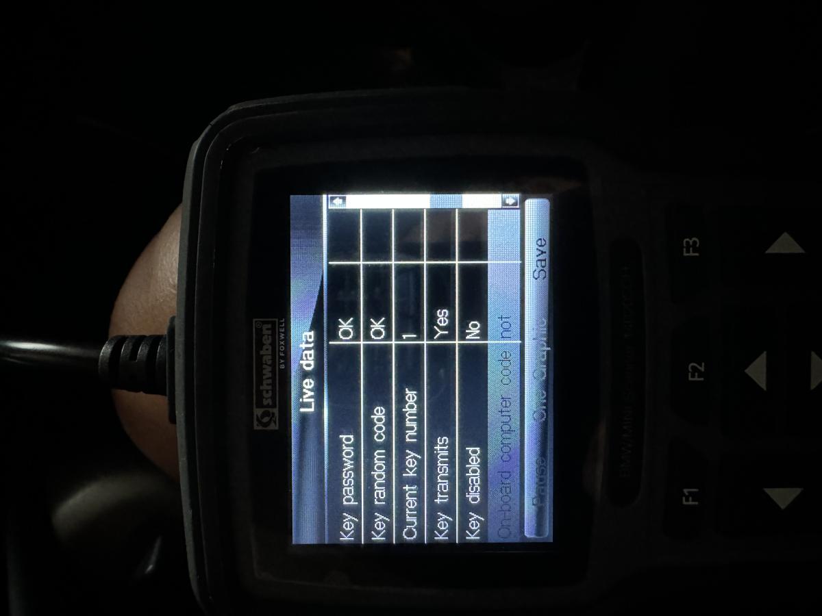

                          Use inpa to read the EWS status to find out what causes the disabled crank, such as P/N, SMG, or key/ews. DME is not related to no crank issue.
                            It cranks, just won't turn over. The live data show starter is disabled and starter blocked due to P/N.
                              Are you sure this ews status was read with gear in neutral or gear engaged? It said it's not in neutral. IF starter is disabled then it couldn't crank -- conflicting with fact. Or did someone bypass the the EWS by shorting out pin1 and pin2 together?
