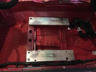

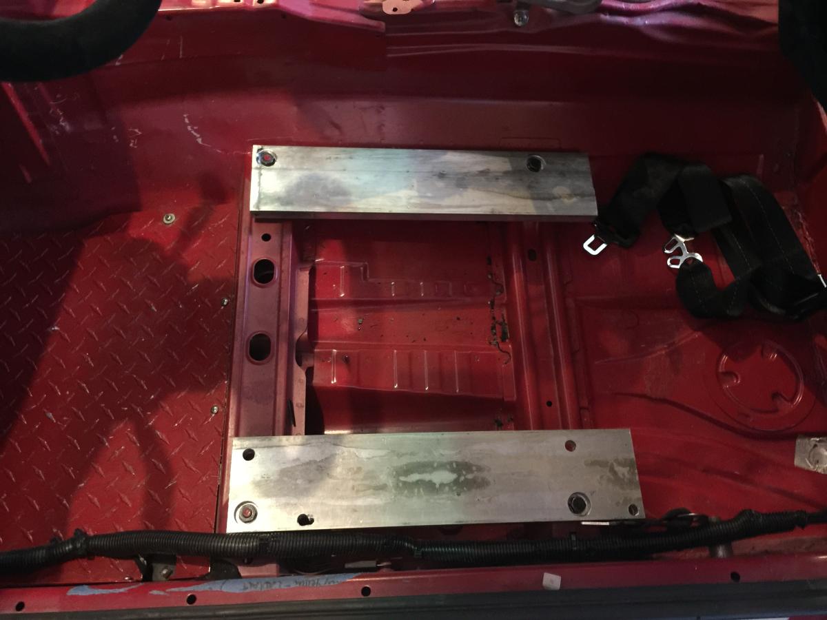

                          I’d be less worried about the seat mountings ripping out of the floor. If anything just stitch weld the mountings. I’d be WAY more worried about just about ever floor mount adaptor I’ve seen. So shitty aluminum ones that have 1/8 of soft aluminum under the bolt head. Then the area galls each time you torque the fastener.
                          This is my floor mount - 3/4” thick T-6061 aluminum. Bolt holes are counter sunk 3/8” so there is 3/8” of aluminum under the bolt heads. And this cost $100 to make. Just need a forstener bit to countersink the holes.
                          Click image for larger version  Name:	42776030285_380fa8ef4e_o.jpg Views:	0 Size:	90.7 KB ID:	309407
