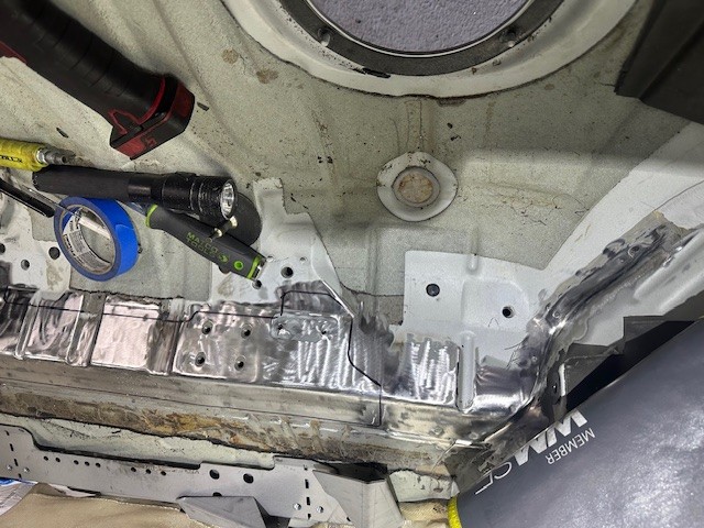

    Need a Favor, Has anyone installed the Stage 2 Front CMP kit?
    Chasing pics of what the install looks like and how it welds to the front top mounts before i buy cheers

    I had both of the CMP kits installed in my sedan. Here’s the pictures the installer sent me of the process. I can DM you the instructions CMP sent as well.
      Unfortunately the pics my shop sent me are hella small, and when I try to upload them here they are upside down.

          Brilliant thanks everyone for helping me with this purchase, Much appreciated
            Here is mine:
              Highly recommend both of the bolt in braces CMP offers in addition to their topside kits. Night and day difference in torsional rigidity.
                Some great pics here and exactly what i wanted to see. I have asked CMP several times over the last few years for install instructions in order for me to get quotes and find a person to do the welding etc. but they never sent them to me.
