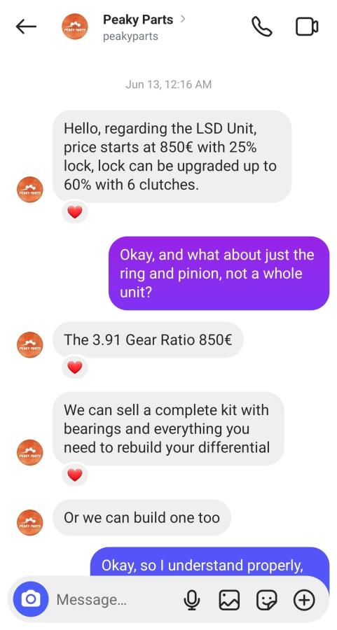

                Regarding the diff, i bought a 3.91 from peaky parts, his name is Pedro and is in Portugal, 850 Euros, he has shims and everything else needed if desired. Unitrax in Corona did the install.
                    I’ll need to do some research and find out what parts I need to obtain for a diff rebuild. I’ll look into peaky parts thanks for the reference.

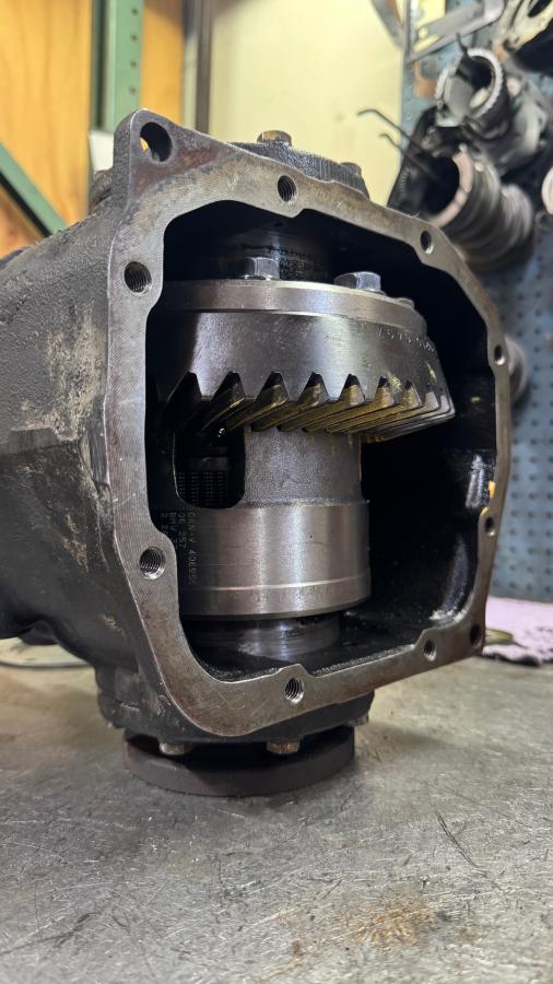

                      If it is the LSD unit causing the issue, you don't need to even pull the diff out. Remove the back cover and axles, pop the stubs off and remove the carrier covers while supporting the LSD unit. Depending on how careful you are, don't even need to change the bearings. If you have a V2, don't need to remove the ring gear. If it is a V1, you have to remove the ring gear. Technically you should replace the ring gear bolts, I reused them on my diff. I'd replace them if they are the original ones.
                      It will be a bitch getting it back in unless you have a second set of hands.
                      I'd be interested to see what the diff and LSD unit looks like out of curiosity. I still have a hard time believing that noise is a diff issue but also hard to tell from a youtube video,
