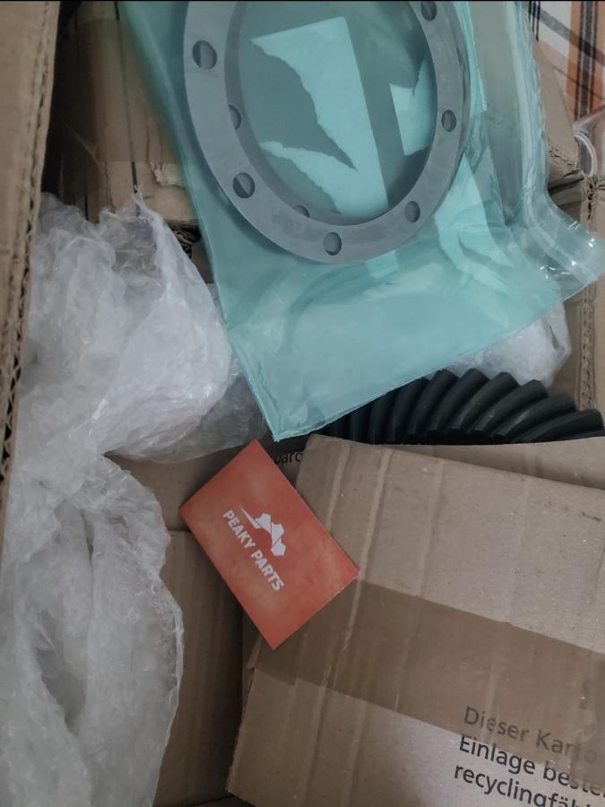

    Hey Fellas,
    I just purchased this 4.10 diff used. I bought a cover (with bushing pre-installed, so I switch it over and took some pics. Does this look like its REM polished to you? Im not sure what it looks like, so want to reach out to the experts.
    Hard to tell., better pics would help. From those pics doesn't look like it is.

            Hey Fellas,
            OP, can you take photos of your teeth to see how it meshes, from coast and drive sides? I want to compare to mine.
              I put it in last night, so apologies as those were the only pics I took. Ill ask my friend if he has any.
              I did look at the teeth, as this is a used diff (10k miles), and there was ZERO wear marks. I thought that was weird, but it was also 330am, lol.
              Drove this morning for about 45 miles its almost SILENT.
              There is a SLIGHT hum when coasting steady on highway... like 1 out of 10 noise (if stock is 0 out of 10). Zero off throttle whine, zero heavy on throttle noise.
              I have the receipt from the shop that installed it, but im EXTREMELY happy as whine would have killed me.
