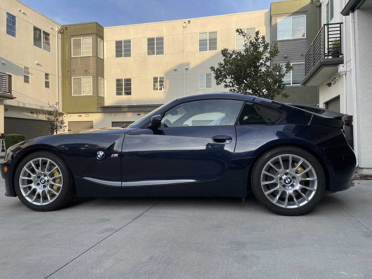

                    well, I made the choice to go with PS4S, and stuck to my odd size choice.
                    235/40F and 245/40R.
                    I love my wheels and visually I think suit the car, so for now I have no interest in changing the wheel, also, the front width and offset, though not perfect, is not that far off from the OE size which is 8in with 42mm offset. The 216s are 34, so 8mm more.
                    The more square look of the PS4S shoulders should help with looks.
                    The OE size is 26in in diameter, the new will be 25.4F and 25.7R, so is 1.1% difference between the two. The fronts are same weight, and rear is 2lb lighter. so for a fast road setup I think is a good compromise.
