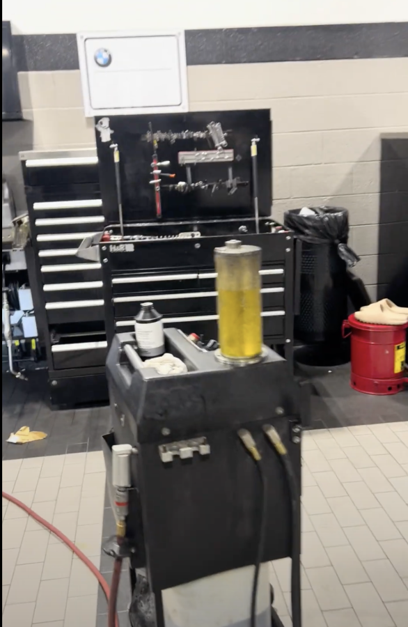

    The brakes on my E46 ZHP with stock brakes and braided brake lines feel great for a non-m. I believe because my friend who works at a BMW dealership used their big power bleeder that pretty much runs all the old fluid out the system completely. blurry pic attached of what the machine looks like.
    Click image for larger version  Name:	Screenshot 2025-07-22 at 11.44.44 AM.png Views:	0 Size:	521.2 KB ID:	312775​
            What pads do you run on the 996 bbk? Wondering if pad choice is as important on the bbk's. That's a nice machine. I've gone as far as bleeding abs using INPA with a pressure bleeder.
