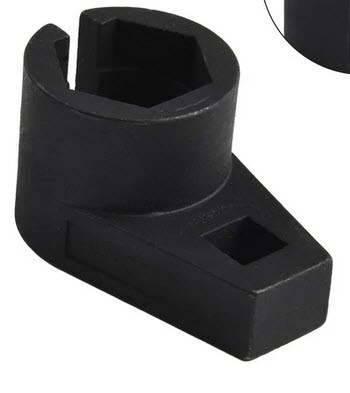

          I have the Supersprint catted section one. I have swapped the O2's with the exhaust in place using an O2 sensor wrench.
          Something like this:

            Ok - yes if I were going to be successful, I was thinking a crows foot.
